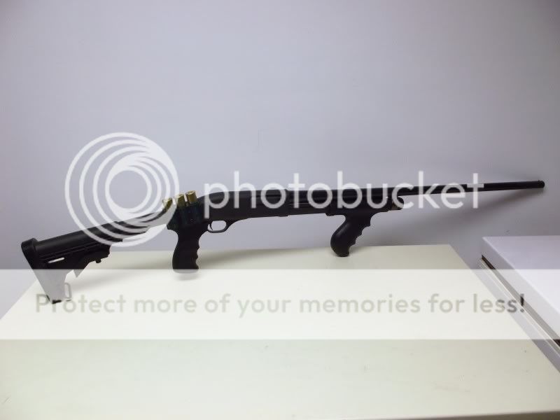

This is my old wingmaster with an 18.5" Express barrel (3" chamber) with choke tubes and a +2 extension. I have cut down the stock and mounted a limbsaver recoil pad to take some of the sting out of slugs and buckshot.

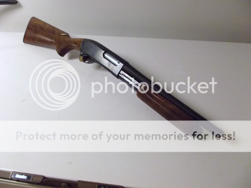

:agree: 3" in a short barrel is good if you need a flame thrower. I just shoot 2 3/4 in my 14" and did what forbes did. 14" barrel on my 2 3/4 wingmaster.
but swapping the other barrel just looked ridiculous :redface:
