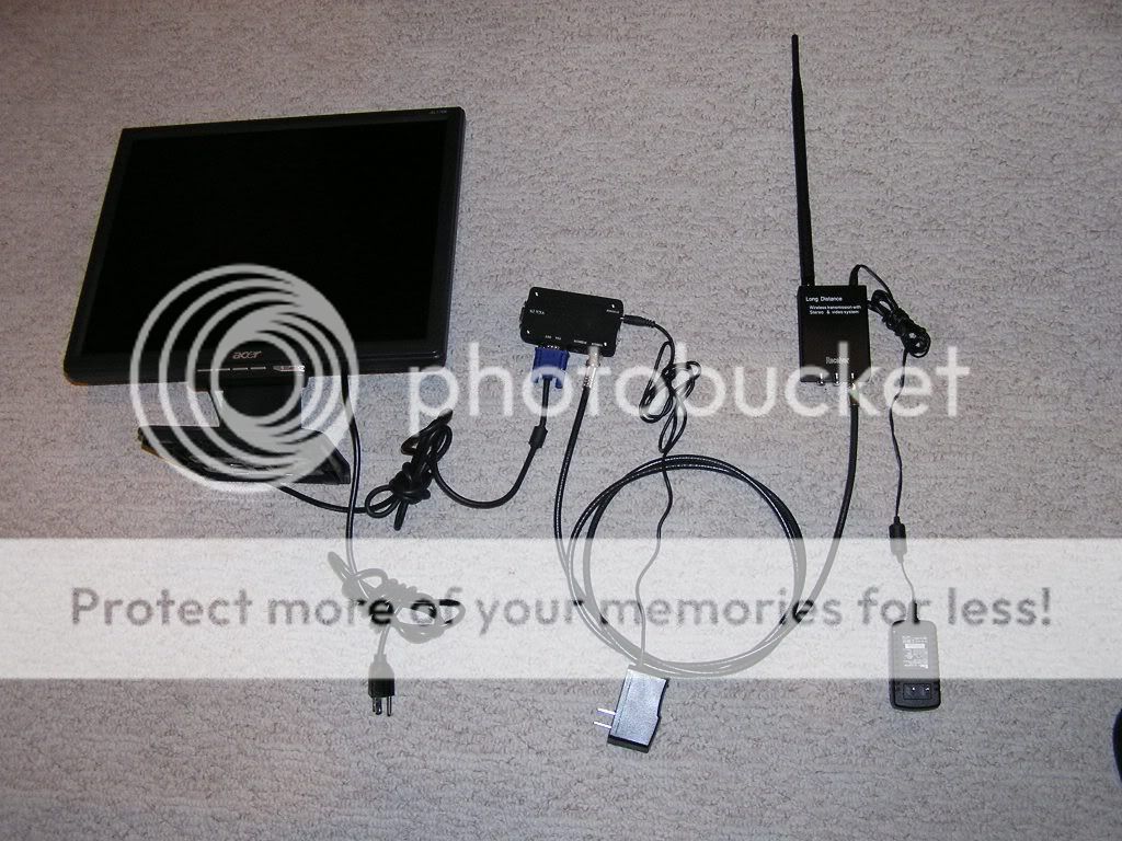

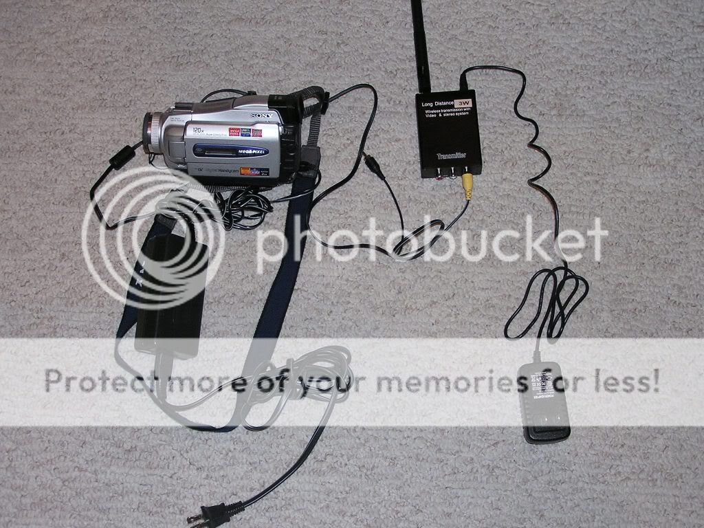

You guys have taken this to a whole new level. I just wanted to see a few bullet holes at a 1000 yards, which was easy with the setup as originally posted. Very interesting reading though.

It looks good. It can hookup to my Canon XH-A1 which has a SDI output.
It has to be SDI, not RCA, correct?
Good question? Mine came with RCA but I'm sure you can adapt to SDI. If you type pin hole camera or spy camera on eBay you will find them really cheap and they usually have wide angle lenses just large enough to place the camera roughly 6 feet in front of the target and still only have the target in view. I bought my cameras at $15 a piece and still have not hit the first one. Damn I just jinxed myself. If your adapting your camera be ready to part with it just in case you hit it.
