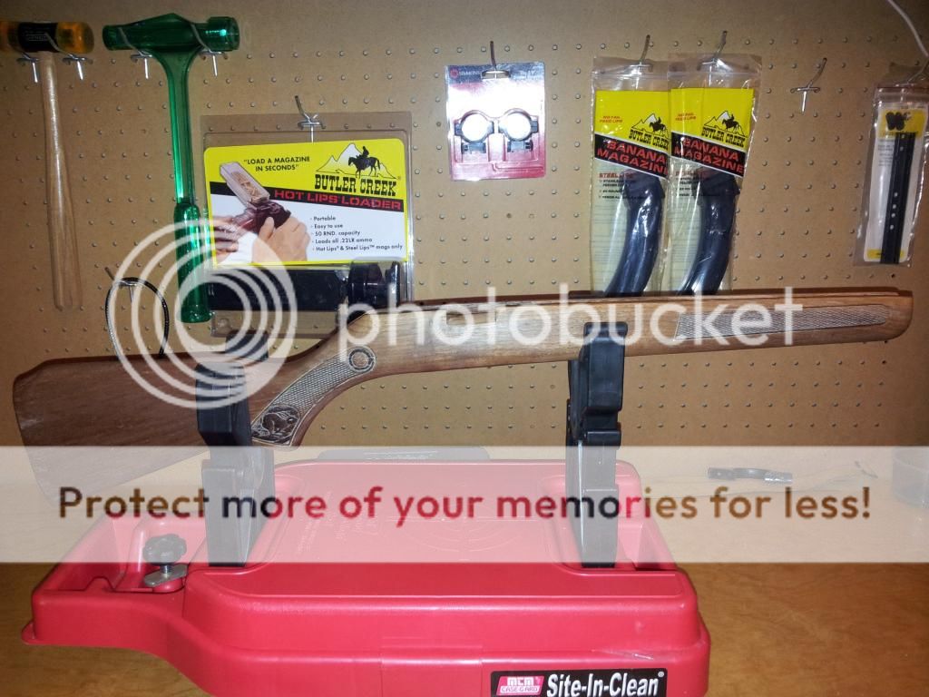

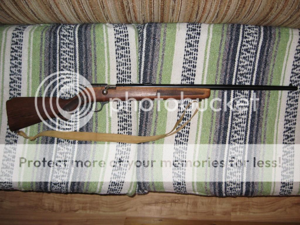

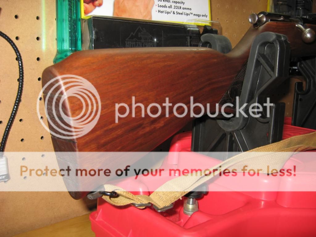

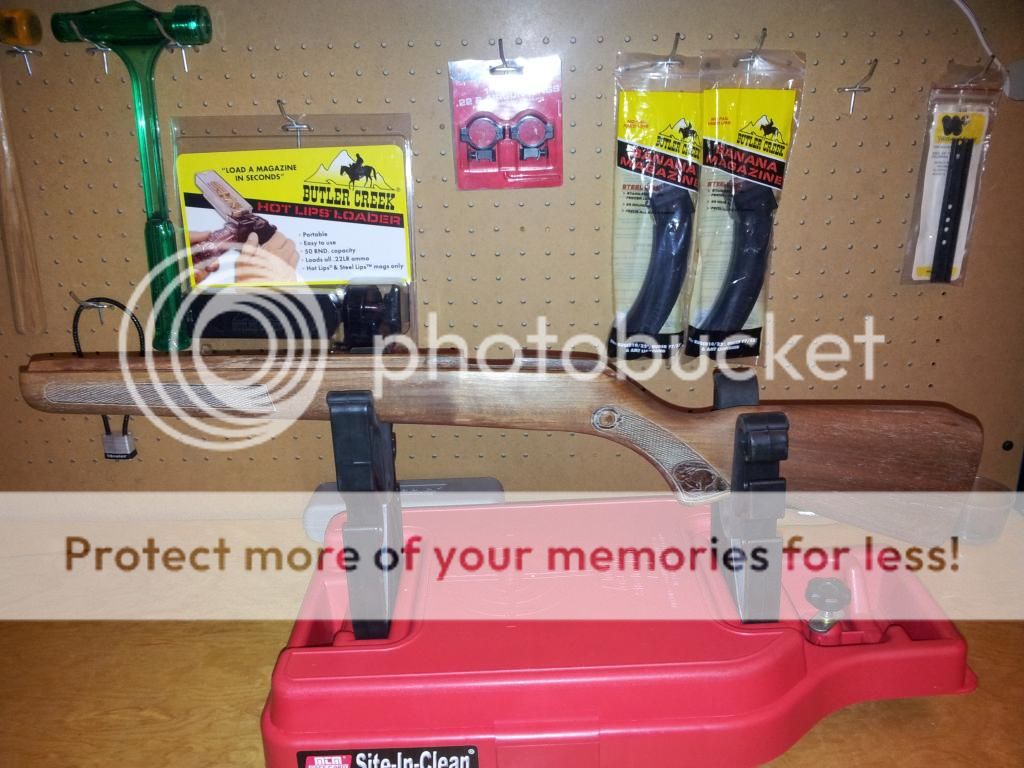

Hi guys, I picked up the little rimfire for 65 bucks. It was in good condition, but in need of a good cleaning. So when I got home, I took it apart and went to town. In order to get to all the little nooks and crannies, I used the pressurized "Blast & clean" from Hoppes. When I was done, I put everything back together and wiped down the barrel and stock with a slightly oiled cloth. Fast forward a few days, I pull the little guy from the safe to show it to a friend and the stock is all messed up. Residual solvant made it's way all over the stock and lifted the original finish. It left white streaks were it driped down.

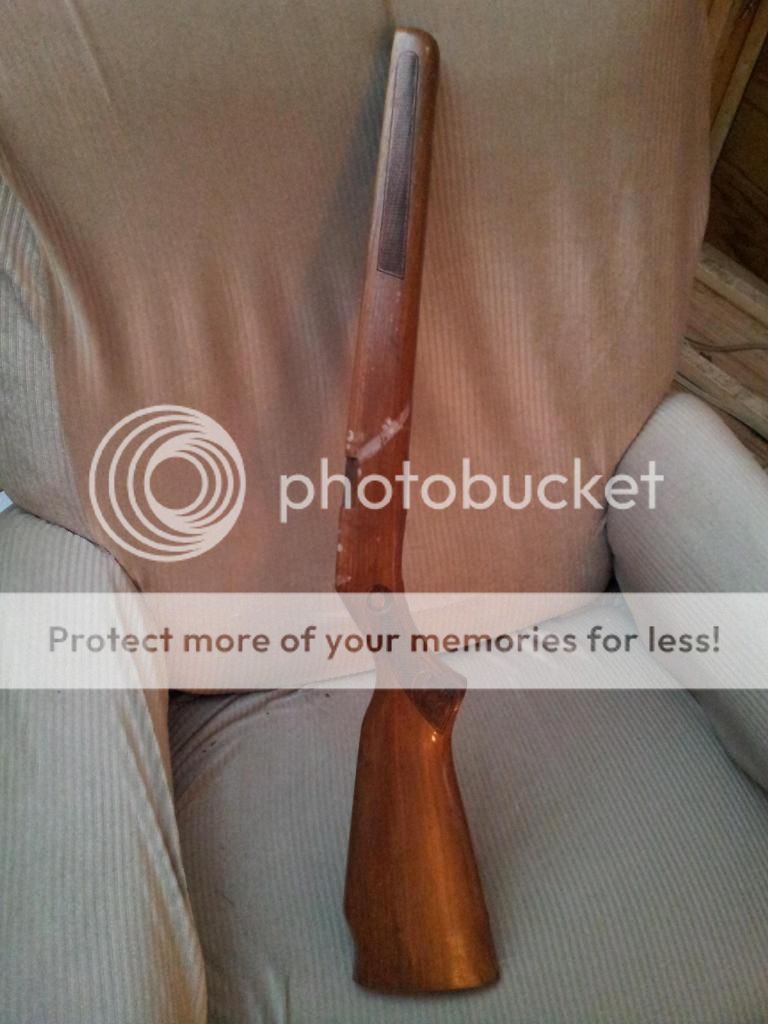

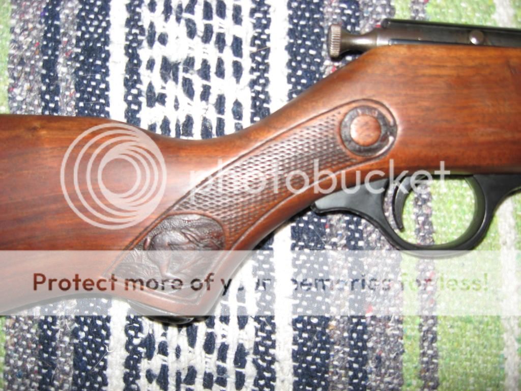

I thought this was the perfect occasion to try something new. I would refinish the stock and shorten the LOP so that my sister and nieces would have a properly sized gun to shoot. So I went out and purchased some Circa 1850. I was amased to see how well that product worked, very little effort was needed to lift the old varnish. I used some 0000 steel wool to lightly clean the engraved or checkered areas and scraped off the rest.

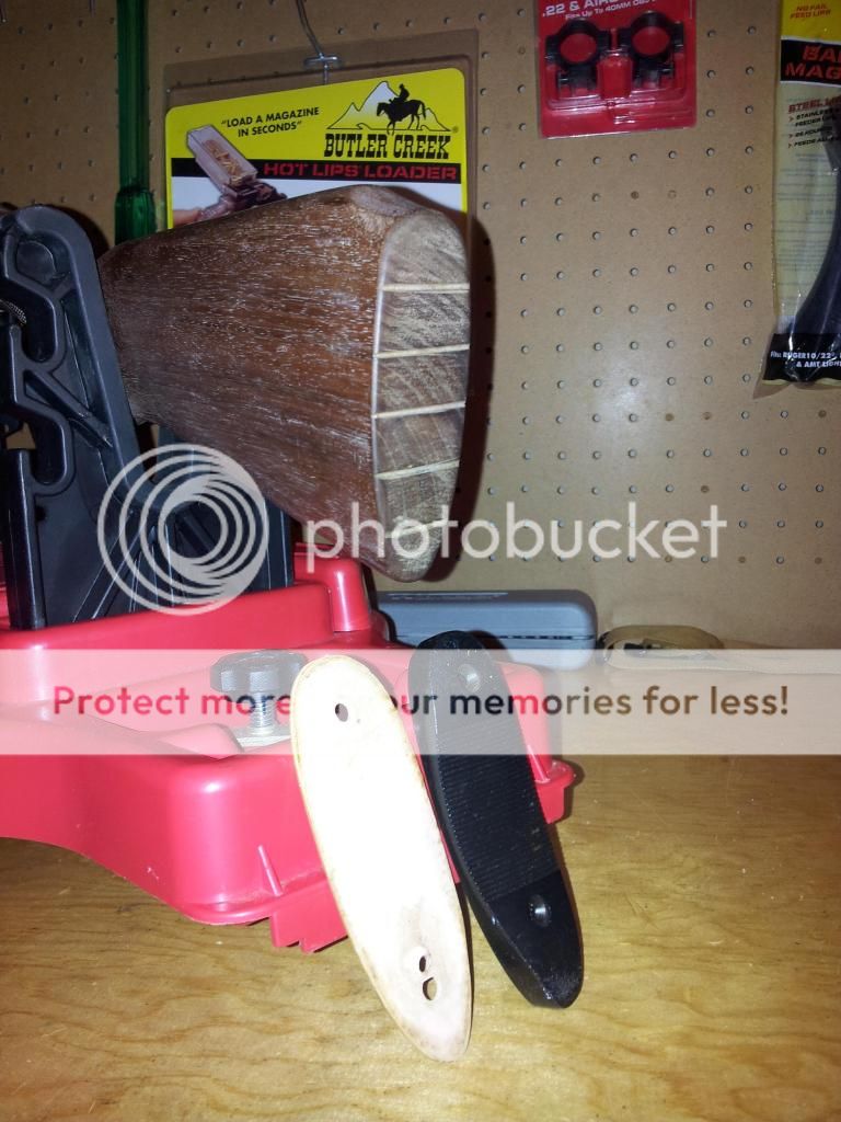

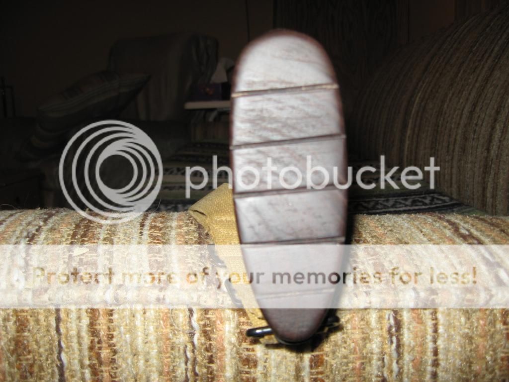

I wraped the butt of the rifle in a rag before I clamped it in my vise. I used my digital caliper to mesure off 1" from the end of the butt, marked it and layed a strip of masking tape along the cut line. I used a hand saw and slowly cut, checking my line often. When I was done, I confirmed that I could not easily reuse the original plastic butt plate as it was now grossly oversized.
I remembered having an old pellet gun as a kid that only had notches cut as a butt plate, so I decided to take out my triangular file and give it a whirl! I have never done anything like this, so I'm just glad I have not broken anything... Yet!
Next step is to find a good finish to apply, any suggestions?
