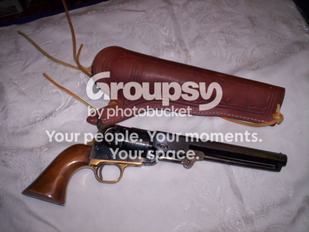

I just bought a Pietta 1851 Colt steel frame in .44 cal from the EE and would like to take it to the range this weekend. I have some BP substitute (Jim Shockey's Yukon Gold) and a Colt pattern flask with a 15 grain spout,with the BP substitute I get 10 grains weight as the substitute is lighter than real BP. The label on the powder container says that the substitute should be used as a volume for volume replacement for black powder. Does anyone know what a normal load for a .44 should be using real black powder???If I know that then I can figure out how much substitute to use, also should I use a wad under the ball or just lightly compress the powder with the ball........thanks:confused:

I was all set to go to the range but the cylinder lock-up spring broke so there is nothing holding the cylinder in place...could be dangerous. Now I am looking for some good screwdrivers so I can fix this gun and others. Any one know who can supply gun smithing tools. Both of my BP revolvers are out of commission now and I can't seem to get any action out of the dealer so I would like to do it myself and save some grief.

Did that and had the gun apart in 5 minutes the lock-trigger spring is broken,sent to Marstar for replacement kit. Thanks for the help with this.

I've seen some replacement springs for that two leaf cylinder bolt and trigger return that are formed from round spring wire. If you're a handy sort you could replicate the shape out of hobby shop music wire and a few minutes of your time and get shooting while waiting for the new two finger leaf spring to arrive. I've got a picture of what they look like but I don't want to bother with hosting it at Photobucket. PM me your email and I'll send you the pic so you know what you're trying to make if you're interested.
Thanks BCRider for the idea about the spring, that is a good one and I am sure it would work but I am not in a rush and the kit that I am getting has a new hammer,cylinder lock and pawl as well as the spring. The screws were buggered buy a previous owner so I am fixing them up as well. I am going to replace as many parts as I can to help with reliability.:cheers:
