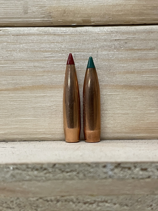

Match bullets (for twist rate 1-8 minimum) shouldn't make much difference and my guess is that it stabilizes quite well. How much difference in the length is there compared to the 75gr ?
Can't remember but longer then SAAMI spec and longer then a Tikka and AR mag.

Here’s a visual. 75gr ELD vs 77gr TMK
