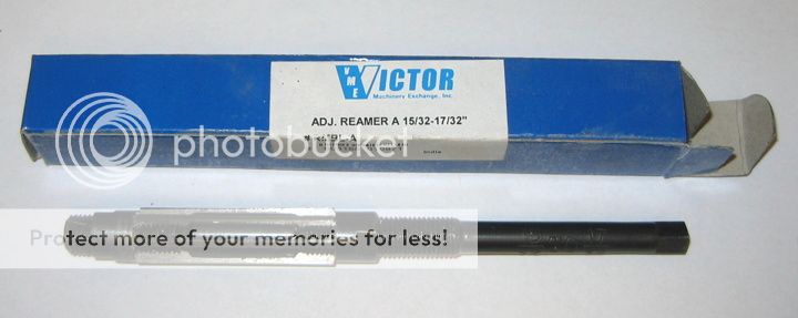

Been looking at those expanding reamers... want to get some steel stock and ream it our for a cannon barrel. Do you use them by hand or in a machine?
There are both kinds (Machine, and Hand) reamers available.
Simple way to tell them apart. A machine reamer generally has a 45 degree bevel at the front, that is the actual cutting edge. A hand reamer has a long slow tapered cutting edge.
It's a minor PITA to keep a machine reamer running in straight, because it does not align itself with the hole well. The long slow taper of a hand reamer makes for a heavy load on the shank, lots of opportunity to chatter, when used in a lathe. Seen MANY twisted wrecks that way. At the price of expandable reamers, using a hand reamer in the lathe is a poor way to waste money. And unless you are reaming through a hole, you end up with a taper at the bottom, with a hand reamer.
These are hand reamers. Made in India, so likely not commercial quality, but OK for what I needed them for. Probably not the ideal tool for a cannon barrel, though.
