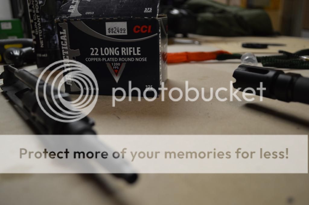

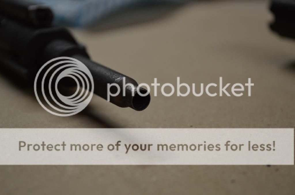

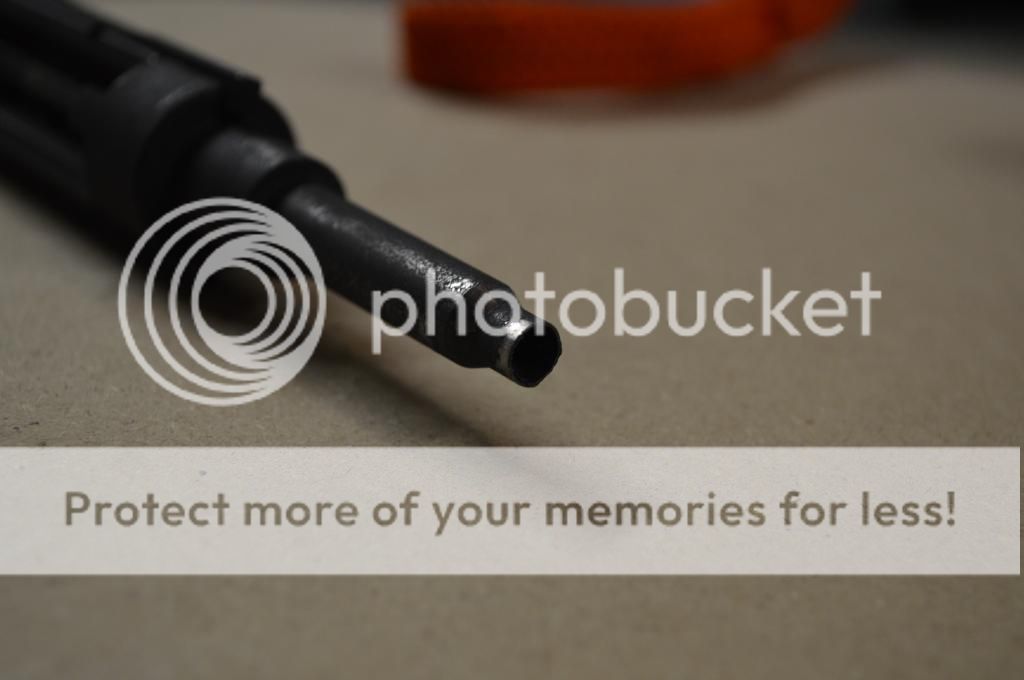

So on my last two range outings I've noticed that my AR + CMMG conversion was spraying bullets all over the place whereas it use to be quite accurate. Even the sound of the ammo when it fired seemed bizarre. At first I assumed it was an ammo issue but the ammo works just fine in my P226 classic. Today I inspected the end of the conversion kit that slides into the chamber of the barrel and it looks a bit jagged.
Pics up later. Anyone else have this issue???
If it is in fact missing bits of steel is my barrel going to be damaged?
From looking at your photos your kit needs a good cleaning and avoid the lead bullets. Stick with copper washed. Like others have said, take a .22 chamber brush on a drill and use it in the chamber insert after you soak it in whatever cleaning fluid you use.
After a lot of use the neck on my chamber insert cracked. I contacted Spike's Tactical and sent them photos. They mailed me a free chamber insert. If yours is damaged I'm sure CMMG will do the same. However, I am sure it is dirty and needs to be cleaned.
It is very dirty. I've got most of the gunk out of it now but the barrel / chamber insert isn't as clean as I want it to be. I think it was so dirty that the bullets were being deformed as they left the barrel, hence the strange shot noise and the terrible accuracy.
I think you are right. That conversion can be disassembled for cleaning. I would give it a good soaking and then buzz internally with the bronze brush. Another trick I have found works well for me is to coat all the areas that get fouled up badly with Froglube before shooting. The FL keeps the gunk in suspension for easier cleaning. Do not forget to clear the chamber and bore before shooting!
