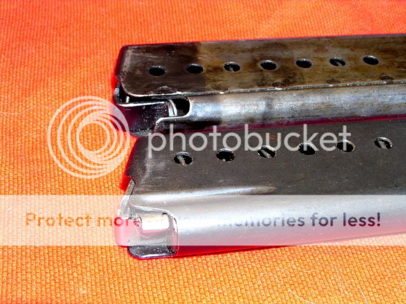

Left: O.E.M. Sig 210 Mag
Right: P38 Mag.
Note difference in angle of bottom plate to magazine body.

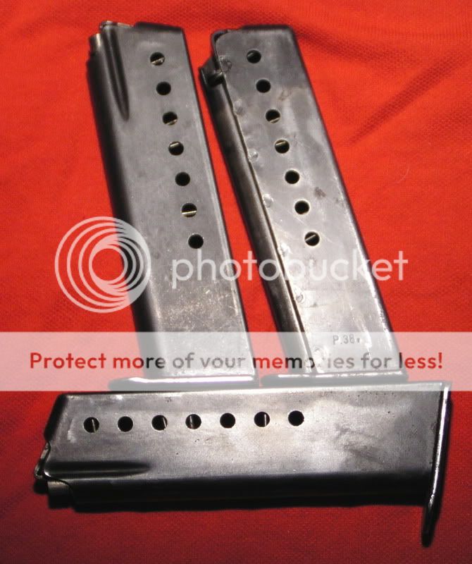

Top: P38
Bottom: Sig 210
Note difference on front of mag follower. You can see why the P38 mag will not hold open.

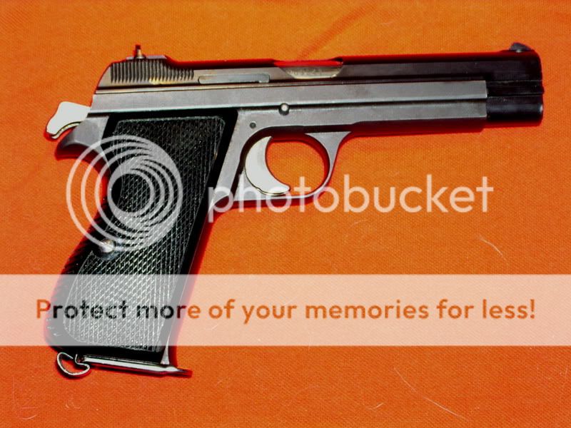

210 with Sig 210 Magazine

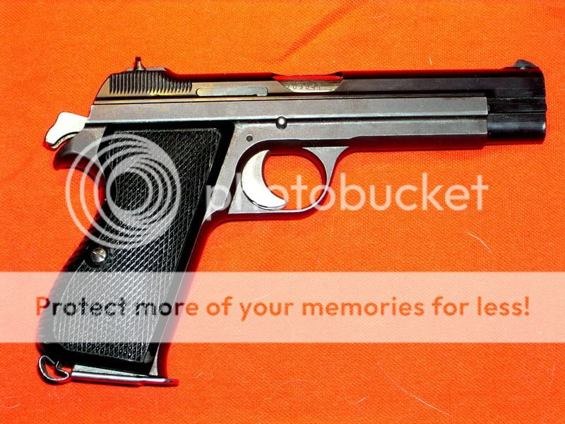

210 with P38 Magazine.
Dummy rounds do feed from this P38 mag into this 210 pistol, despite the fact that it is not locked in the heel catch.
