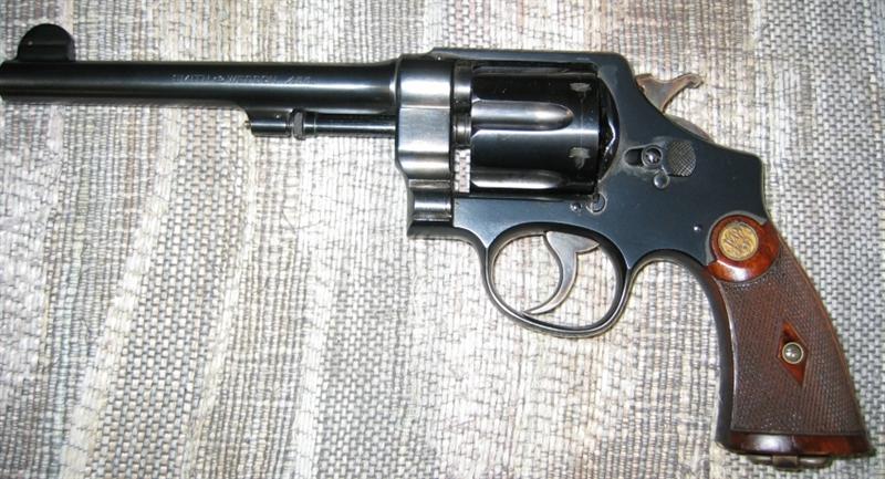

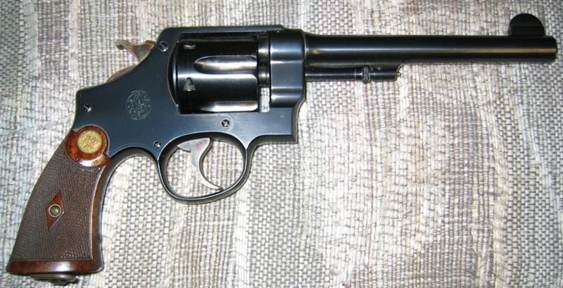

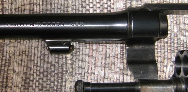

Here's a few pics of a 1917 S&W .455 Hand Ejector that is part of ~Angel~'s WW1 collection. It's serial number is # 446xx and it's military marked on the butt, opposite where the serial number is stamped.
1917 S&W .455 Hand Ejector (Provenance - owned and carried during WW1 by a Canadian Officer from the Kingston area
(Click PIC to Enlarge)(Click PIC to Enlarge)
Hope this helps...
Regards,
Badger

Badgerdog- Thanks for posting the pics. I really think now that this is a reblue that I was looking at.
The officers full name on the Holster read- Capt G.H. Colclough RCA. It was ink stamped and witten in pencil. I looked in the CEF attestaion papers but could not find anything there.
The dealer was asking $550 for it. It has no C broad arrow markings or any other british markings. This could mean that it was private purchase. I know these were still used in WW2 but I didn't think Private purchase pistols were as common in WW2 as the were in WW1.
Thanks for any more help you can provide me with,
Cam
