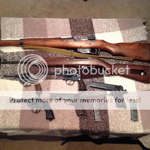

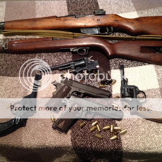

I took some of these pictures for the wanstalls contest, but you guys might appreciate these as well. The .455 is a safe queen, she don't get out much as I'm sure you can tell by the condition.
Cheers.
The 1918 .455 webley auto colt was ordered with approx 20,000 others like it directly from colt in 1918/1919. Ordered specifically for the RAF (royal air force), in a unique ammo in order to maintain supplies specifically for the british air force in WW1. It was then stamped again after being re issued for WW2. It's a pretty rare piece, and the condition is better than my brand new norinco out of the box.

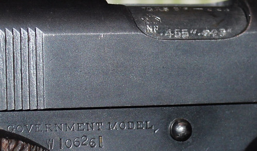

Hi,
Sorry for the delay in this reply, I've been too busy to sit at my computer the past few days. I see you have now listed the pistol on the EE. I think you need to double-check your resources, as there's many errors in your information.
Your pistol was part of Contract No. U.S. 6755-MM264, placed May 7, 1918. This contract was for 10,000 additional RAF pistols at the rate of 600 per month, with 30,000 extra magazines.
Your pistol number W106261 was shipped Mar. 20, 1919 several months after WWI ended. It was near the end of the contract and thousands of pistols are in the 'series' prior to it.
It has the following standard markings from that shipment:
RAF: Hand stamped by armorers, signifying Royal Air Force. Pistols serialed above W100000 without the RAF mark may have been sold to individual officers or issued to other military organizations.
Broad arrow: The standard British government property mark.
Crossed pennant: British military proof mark stamped at Colt.
G2A Inspector mark: Inspected and proofed at Colt by British inspector G.W.R. Stedman.
The pistol also has the following non-standard markings applied since leaving the factory:
Magazine serial number: 1911 magazines were never factory numbered to the guns. Whatever serial number is on the magazine was applied by someone after it left the factory. It could be an old RAF rack number, some units liked to apply such things and I have seen them before. Not too often found on magazines. I wouldn't be surprised if the magazine also had a broad arrow applied.
British commercial proofs on the barrel: From your EE ad, the barrel on your pistols shows British commercial proofs that began being applied in 1955. As such, the pistol did not leave the U.K. prior to 1955.
**Besides the obvious post-1955 export proofs, it would be highly unlikely that a Canadian pilot would have carried a pistol chambered in .455 auto during WWII. That ammunition would have been extremely difficult to find. A few Canadian pilots are known to have carried 1911's chambered in the more common .45 acp during that time.
The finish on your gun is not original and while it's hard to say from the photos, it's probably an arsenal re-finish. Many of the RAF pistols sold as surplus and brought to Canada at the same time as yours had that finish. It appears however that this pistol did not receive the Enfield inspectors mark at time of refinish - I have observed others like it. It is also possible it was parkerized commercially by a previous owner.
While your pistol is not what you describe, it's still an interesting gun from the inter-war period that served with RAF during that time.
For additional research, the best book for British 1911's is Charles Clawson's 'Colt .45 Service Pistols' also know by collectors as the 'big book'. This is an expensive book and sadly out of print, but nobody else has accurately covered the British contract 1911's to same degree of detail.

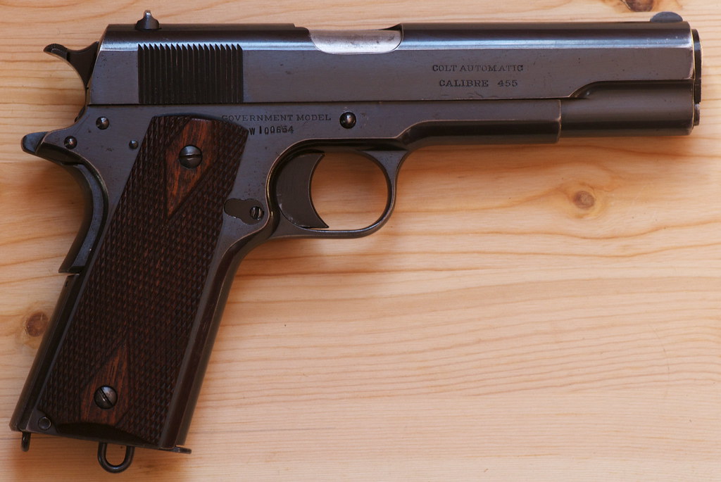

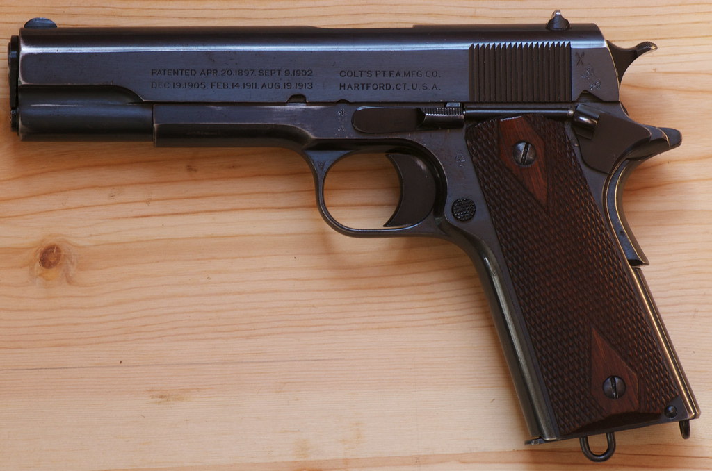

For comparison, here's a true original example of a British military 1911 in .455 shipped Aug. 2, 1918 prior to wars end. This pistol is an authentic 'bringback' by a WWI Canadian soldier and you can compare the bluing for yourself. You may also notice the British property/inspector marks were applied after the pistol was blued. There are also no commercial export marks.
