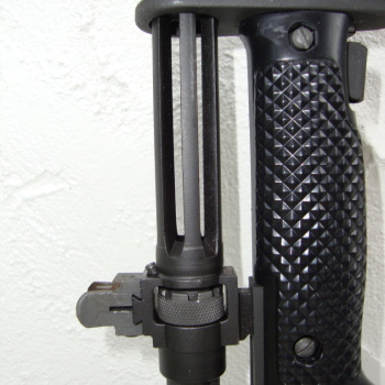

In your pics you provided it looks to me that you need to rotate the castle nut some more to get the set screw to sit inside the slots of the castle nut ...And did you try flipping the gas locking ring over as this will sometimes get it to lock up correctly.

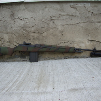

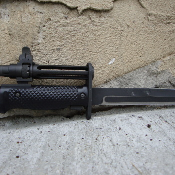

Nice looking gun Sir and excellent deal on the bayonet :)
