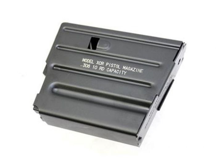

Does this work in stag 10
I ordered two and they do not work in my Stag 10, won't stay locked in.
If I slap them in real hard they will catch, but as soon as the bolt carrier moves they fall out. Also, tilting the mag to one side while inserted will cause it to fall out.
Pretty disappointed, going to see if there's anything I can do to modify it to work.
We have found on the odd Stag the mag catch is a couple thou larger, everything else we have tried them on is dilemma free. If you use a small file and file the sides of the mag catch on the magazine problem solved.
Fantastic, will try this tonight. Thanks for the reply. So basically make the hole in the mag a little bigger?
