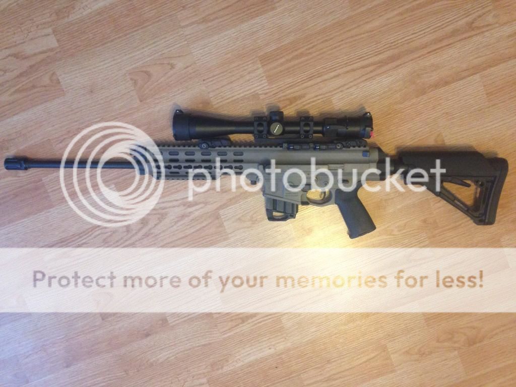

I'm running the Dlask adapter with a magpul CTR. And I also have a cheek riser, can't remember but I'm pretty sure it's 0.5" only. Perfect with a vortex scope in an ADM recon mount.

I'm using a CRT stock, I find it excellent. I also use a 3/4 cheek riser as my scope mount is a 1 inch high mount, that allows me to clear the BUIS. You can remove the BUIS and go with lower mount , thereby eliminating the cheek riser. As for recoil, I didn't realize there was any , with the xcr-l .223 end. :) 53 g vax works well in mine.

My scope mount was a 1 inch rise aero precision , the 3/4 worked perfect for this. The mount on eatredmeat's rifle looks lower , therefore a lower Cheek riser. You kinda have to match the riser with the mount. Regards to brakes, I thought you mostly see flash hiders on Black rifles (.223). So that's what I got. I had a brake on a su16 and it was the loudest thing ever. I've now got a s&j linear comp and it's nice and quiet.( I don't need to worry about earmuffs if hunting. I do wear hearing protection while at the range( shooting a few hundred in a day). I think the only benefit of a brake as opposed to a flash hider , would be muzzle lift.? I found quick multiple follow up shots a bit better with the brake ( especially when using magnification.)

The nice thing about the ctr is the secondary lock. There is no wobble at all like other buttstocks. I have the 3/4 riser on mine it puts the top of the riser parallel to the top rail. Im confused by your post about the buffer tube and recoil? The buffer and spring do nothing for a xcr rifle there is nothing to buffer lol
