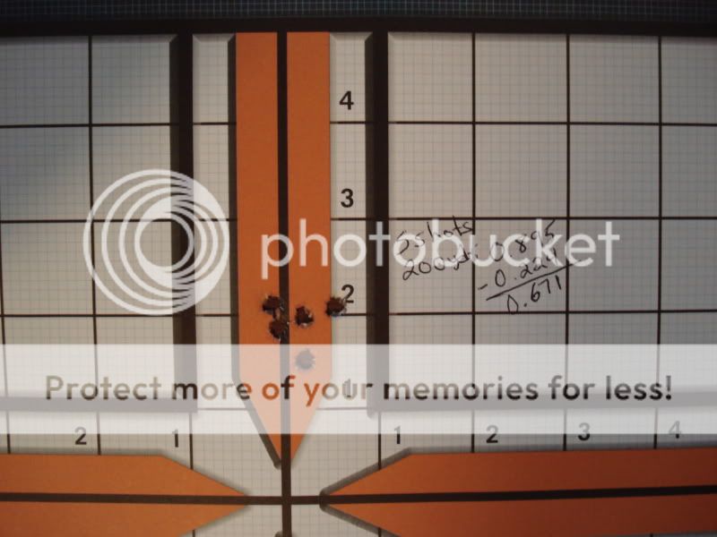

What are you using for a bolt gun?
Savage model 11 action with detachable mag
Glass Bedded in a HS precision varmint stock in snow camo
26" Shilen select match varmint contour 1-9 twist
.220 AI shooting 75gr A-max
Timney trigger at 2 lbs
Marksman winter knob
Farrel 1 piece 20 MOA rail
Burris Signature Zee rings
Vortex Viper 6.5-20x44 with flip caps
Somewhat of a picture
Last group at 200 yards
Nice rifle and a very nice group.

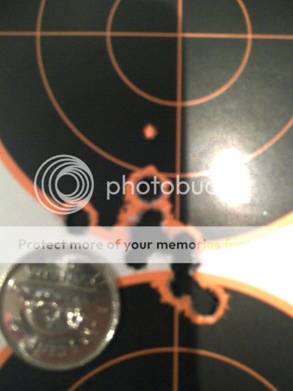

I shot this 10 shot group with red box 223 55 grainers at a 40 yard indoor rifle range with not too bad results. It will be good enough for coyotes at any practical range.
I shot some white box 45 jhp's last fall at 100 yards and the 5 shot groups were around 1 1/2". The odd group hit 2". I am happy with the accuracy using cheap factory loads.
