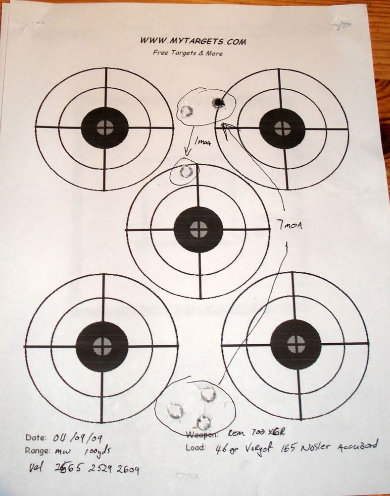

So I took the XCR to the range today for the second time with some hand loads.
Gettin my huntin loads ready to go.
Remington Brass, Federal Large Rifle primers, worked up from 43gr to 46gr of Varget under a 165 Nosler Accubond.
Here's the best I could do with it. The group is .72" Average Velocity was 2567FPS out of a 20" pipe.
The Varget Bottle lists 46gr as a max load with 168gr SMK and Federal 210M primers so I wonder if I could stuff a little more powder into that case....?
I find the Hodgdon loads to be pretty much max for Varget, with Lapua cases anyways. With lighter brass like remington or winchester you might be able to stuff a little more powder in, but watch for pressure signs for sure. That load is probably already a grain or two over what lots of books would list as their max.

i found sierra's data to be WAY under hodgdon's data (for 308win that is)
Yeah, I checked their website and they have a load table. It lists 46 as the max for the 165 too so I probably won't screw around. I don't need a grenaded action.
