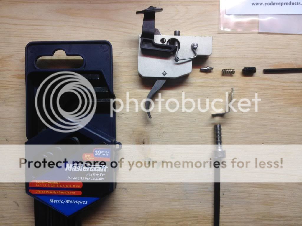

So, I happened to pick up a Yo Dave trigger spring for my Tikka T3 in .223. I had never heard of this product before and I must say, I am quite impressed with how easy it was to install and how much of an improvement you get with such a little spring. The end result: the weight of the trigger pull is half what it use to be and the pull is still smooth with a crisp break. Tikka owners, I highly recommend that you get in touch with Yo Dave and pick one up. For the price it is worth the try.

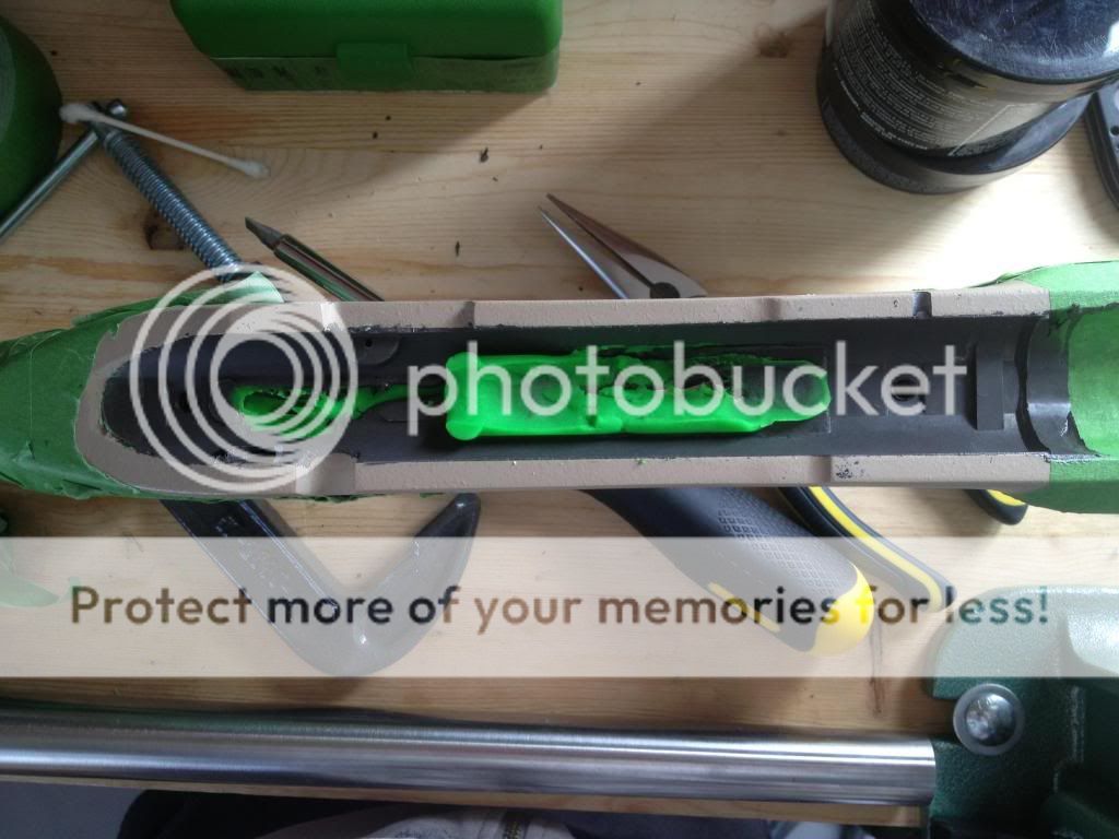

Below are some pics of the installation. I wanted to take it to the range to see if there were any improvements to group sizes but I kinda screwed that part up; I figured that while I had my gun in pieces, I may as well do a bedding job (yes I know this is adding a variable to the equation and thus my test to see if the trigger spring made any improvements is now un-scientific). When I took it to the range I started off shooting prone and things were looking OK (I zeroed on a target that is not pictured below) until I realized that there is a massive amount of mirage that comes off of snow, even at 100m (I was hoping to pass the .5MOA challange. FAIL). I then went to the bench and the groups opened waaaay up. The problem: I didn't tighten the action screws enough. While loading I figured the bedding job may play with the barrel harmonics so I loaded up 3 different loads. It looks like the old load is the one to try again: 24.4gr Varget, 80gr Berger VLDs, .004" off the lands, CCI BR4s, and neck sized Winchester brass.
