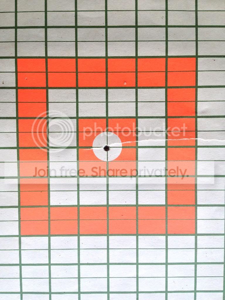

There is no such thing as a 55gr sst bullet. I use 36gr of varget over 55gr nosler varmageddon. Shoots one hole at just over 3600 fps.

Rem 700 1:14 twist,
Hornady 53 gr match bullets
35 grs varget
CCI large rifle primers
C.O.L 2.330"
My best grouping so far 5/16" @ 100yds
For some reason my rifle doesn't like any bthp
