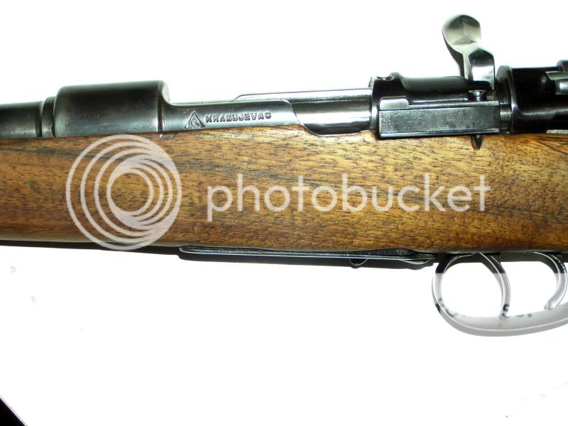

You mean an Zastava sporter action or a Military Yugo Mauser action?

Definetly military in origin but the receiver markings are new to me.
Kragujevac is the factory name - I have not seen this on any of the rifles Marstar brought in to North America. The original Yugo intermediate action was of FN manufacture through the M24. The subsequent M48 derivatives and M24/47 I thought were the same. I'd be curious to know if your rifle was an original Fabrique Nationale manufacture...
Not FN.
Serbian manufacture.
I have no idea why they(I have two of them with serial# under 2000 on left side receiver ring) are marked as they are, but I presume they are made by Zastava, or it's predecessor.
The receiver cutouts may have been left to simplify production. Both commercial and military actions could come from the same line. Bolts are close to a 1/4" shorter than K98 bolts.
Also have another one without Zastava or Kragujevac on receiver, just four marks on receiver and barrel, 7### s/n on right side of receiver. This one is a Bavarian style stock whereas the other two are Mannlicher style stocked
