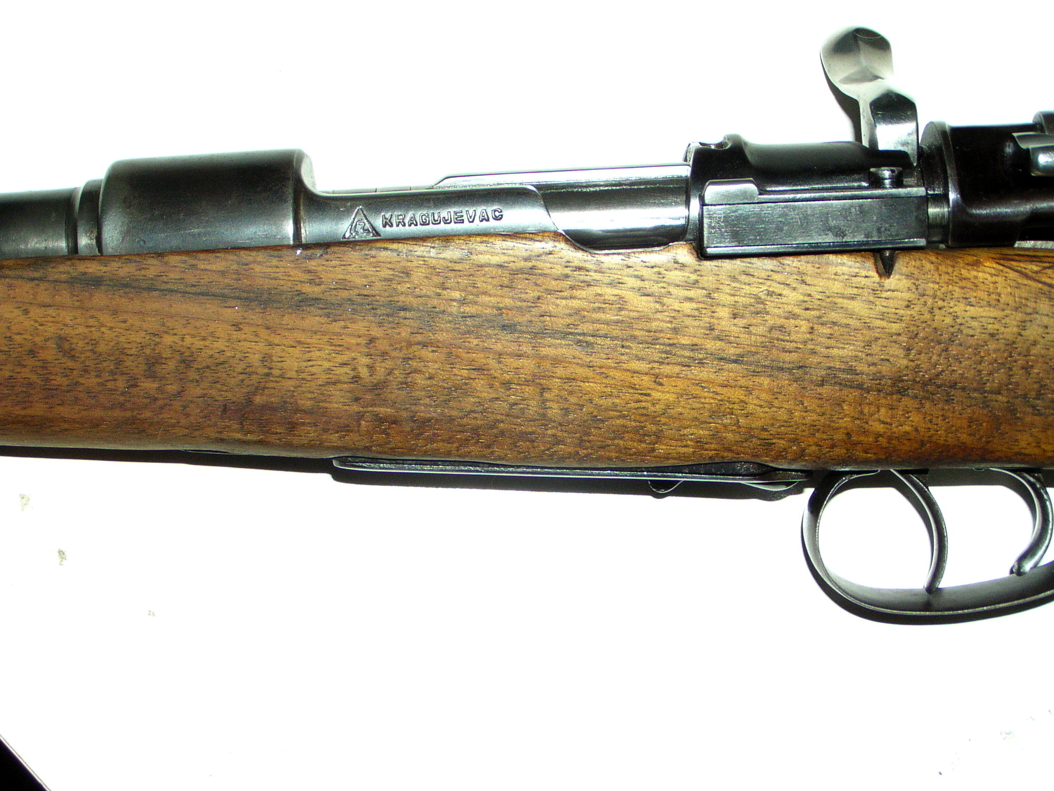

Hey guys,
Just purchased an M48A mauser in 8x57mm. This will be my first mauser, thus my first time reloading 8mm mauser.
Any suggestions of projectiles? What has worked for you guys?
Looking to hunt with this rifle and possibly have a projectile anywheres between 150gr-190gr, but let me know what has worked for you guys.
Planning on using Prvi brass with CCI 200 primers.
Either H4895 or IMR4350.
Thanks
Ben
