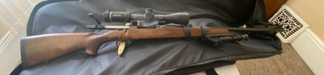

I recently bought a
Picatinny rail from Danger Noodle to mount on my Interarms Mark 10 - (Zastava 98 Mauser), and I have tried 2 different scopes, and both have a windage problem, the exact same issue that when turned to full adjustment leaves me 2 moa to the left of the bullseye - elevation isn't the problem, just the windage. I then tried reversing the rings to see if they were the problem, but I got to the same spot 2" left of the bullseye, so I realized now that there must be an issue with the factory holes drilled in my receiver being slightly misaligned. Is there a workaround to correct this problem?
I want to move it at least 6 moa to the right to allow for using other ammo
are there 30mm windage adjustable scope rings to fit a pic rail? I'm reading that the Burris XTR rings with adjustable inserts won't hold recoil well and can slip. This is chambered in .308 Norma Mag and thumps pretty hard.
