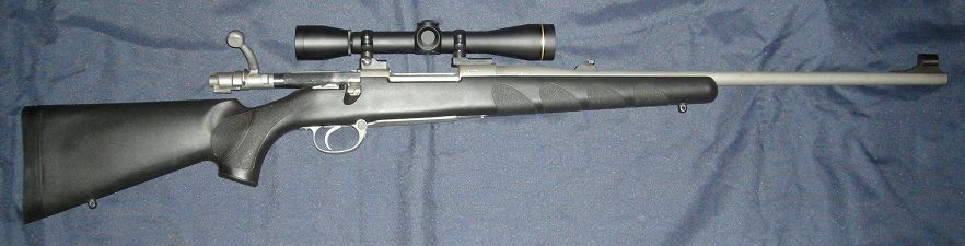

For a backup rifle I got this Zastava M-70 SS 30-06, with good open sights. Its amazing that you can buy a real Mauser-98 in stainless for so little money. A couple of decades back a guy would have given a lot to find a stainless M-98. Granted, Zastava Mausers need to be cleaned up a little, but with a minor bit of polishing and tuning they are as good as or better than rifles costing more than twice as much.
For optics it has an older model ("Made in Austria") 4X Swarovski in Warne QD rings.
I put it in a (NOS) Ram-Line stock intended for a Mark X/Charles Daly Mauser 98 that I got cheap. Perfect drop-in fit. (Interarms Mark X, Charles Daly and Zastava are all basically the same rifle.) I like the rifle better in this stock. In my experience these relatively cheap plastic stocks (Ram-Line, Butler-Creek, etc.) work just fine with M-98s.
Trigger is already very nice, but wish the safety locked down the bolt. However, since this is intended as a budget back-up rifle, there is no three-position safety or single set trigger planned for the future.
In factory stock:

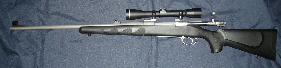

Excellent rifles! I have a stainless synthetic LKM70 .308 (plus a number of blued walnut Zastava rifles). These rifles are equipped with decent adjustable triggers. I load it with Hornady 180gr bullets at 2600 fps MV and groups around 1" at 100 yards off the bench rest -
Zastava LKM70 .308 Winchester with Leupold FX-II 6x36mm scope

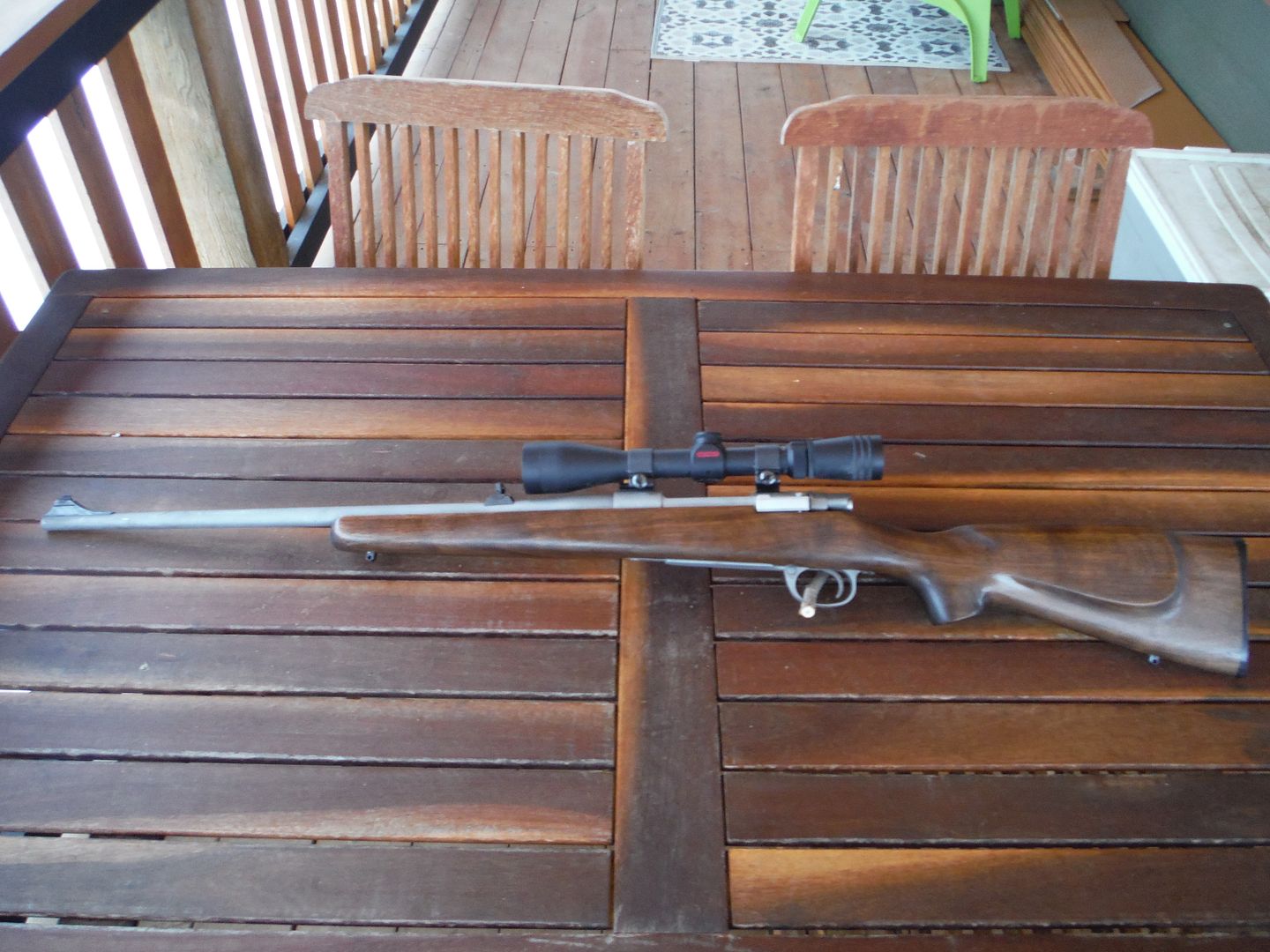

Heres a 6.5x55 I fit and full length pillar bedded in a boyds walnut semi-inlet for a friend of mine. Havent heard how the accuracy is now, but it wasn't great with the old stock(4-5" groups @200)

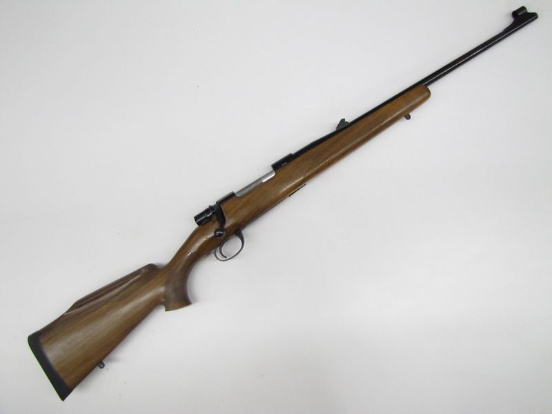

I have a blued half stock M70 in 7x57, bluing is quite nicely done and reminiscent of the old HVA Mausers of the 40's-50's. My extractor was overcut out of the box, probably fit a magnum cartridge but not the 7x57....easy fix however as they are standard '98 extractors. Wood is quite nice, and while it's not Swede or German smooth, it's certainly not bad. Trigger mech is easily tuned to produce a light crisp trigger pull. I'd buy another one....like this one, not a SS or a full stock though, just my preference.

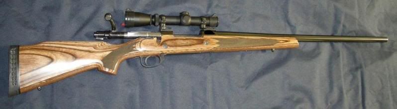

Remington marketed their 798 model, which are Zastava barreled actions in Remington laminate stocks, from 2006 to 2008. Beautifully blued. A functional working rifle. My .458 Win. Mag. and .350 Rem. Mag. -
