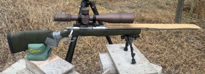

6 inch target, 1000 yards.
Adj. right .75moa after #1, didn’t adjust vertical for 2,3 so it was safe to assume I just dropped the first one.
Adj. down .75moa on #4 but hit 1.0moa lower.
Up .25moa for 5&6.
Rem700. Harris 6-9 bipod. Caldwell bag.
Bell and Carlson M40, Vortex Razor 6-36. IBI medium prefit. 6BR Norma, 107 MatchKing, H-4895, Lapua brass, Fed205.
IMR-4166 works too. Different splash sizes caused by various paint qualities.
Triple the powder and bullet and distance, that’s awesome.
Just experimenting with the tape. Grip is slick and difficult to consistently hold on to.
