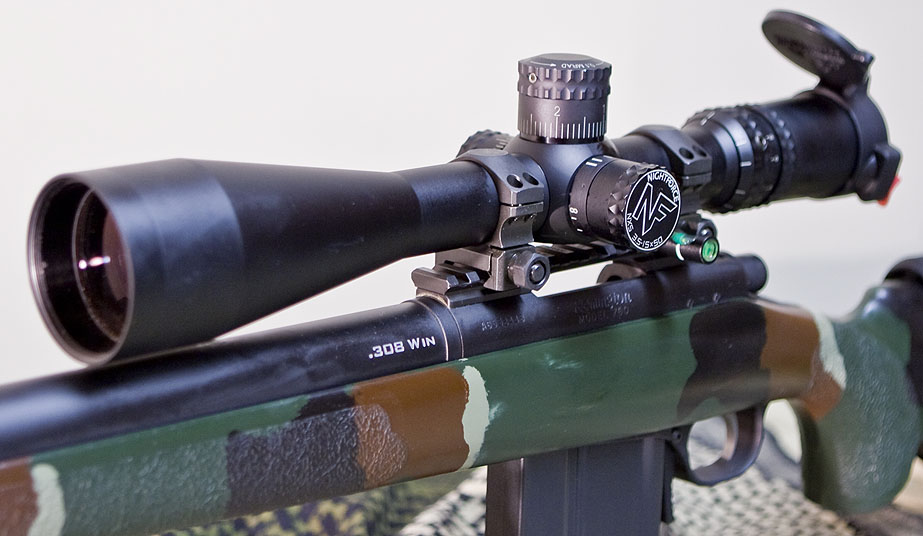

took a recently purchsed rifle to the range today. I had bought the rifle and scope/rings seperate, and found that I ran out of range and even with my scope dialed as low as it could go it was about 10 inches high at 100 yards.
I'm sure I've just done something stupid, but any tips for what to be careful of or double check? Its a build off a rem 700 action with a 20moa rail and a nightforce 3.5-15x
. I know its a long range rifle, but am I wrong to assume I should still be able to get a 100yard zero with a 20 moa rail on?
picture makes it easier to see if I might have missed something... so...
Factory actions are not that precisely machined on the outside and it seems you don't need a 20 MOA base.
You can either shim the front of the base or switch out the 20MOA base to a flat one.

Is your NXS a Zero Stop model? That may be one thing to check. You should be able to get much closer to a 100 yard zero than that. I have 3 rifles with 20moa rails, and all can get down to a 100 yard zero even with scopes with 50moa adjustment.

Definately the zero stop. Your top turret is taller and tapered compared to a regular NXS turret, the mark of the zero stop model.

Obtuned for all your expertise, you sure do say some weird silly stuff. Most likely the OP has his zero stops set high, which clearly he has since you can see that in the pic of his scope. You can also see he is shooting a .308, which even without going to my DOPE i know takes 40 MOA to get to a grand from my 100 yard zero. And furthermore, my identical Nightforce scope to the OP has 63MOA available up from my current 100 yd zero, which just lets me get to 1300 yards with my 20 MOA rail.

Factory actions being that imprecise to prevent you from zeroing a NF on a 20 MOA base... I don't think so Tim! And shimming the front of a 20 MOA base??? Its cartoonish on the best of days. Its analogous to cutting the doors on a cupboard to make them fit crooked instead of just adjusting the hinges. Don't do stuff like this, its a Homer Simpson fix.
No! you won't get anywhere near 100 MOA of travel least with a zero can't base and that Nightforce scope. It does center close to the center contrary to what both of you say.
And you can't put a Remington base on backward. The screw holes don't line up and the back of the receiver is flat-ish while the front is round.

No, the "solution" was only obvious to people with scopes that have a zero stop similar to the OP's setup. I know (tested on the range with a half dozen different scopes on the same rifle) that a 20 MOA base on a 700 in 308 will need to be adjusted to get a 100 M zero. And Jennis wasn't far off, without the adjustment, using 168 gr bullets, it will be about 16" or so too high. If I use a 10 MOA base it is much closer, but still around 3-5" too high. Burris rings and inserts let me tune the mounting to get a 100 m zero with the scope bottomed out for elevation, leaving me all of the elevation for distance ( the scope on there right now is a B&L 4000 8-32x40 with 1/8 adjustments. I change scopes a lot, and usually use this rifle for test as it is consistently accurate no matter what retarded thing I dream up). With a scope with enough elevation, you wouldn't have to do this for a parameter set from 100-1000m. If you want to go further, you may have to adjust the mounts anyway. I recall an adjustable mount from a few years ago, set up to allow 200 yd to over 1 mile. Very cool mounts, hand built. FWIW - dan
I was referring to the orig poster saying he had the scope bottomed while shooting 10 inches high at 100 yards.
I have a 5-22XNSX on a 20 MOA base that has a bit over 91MOA of up travel....Do I have the Remington with the most out of whack tolerances ever made...I doubt it.
