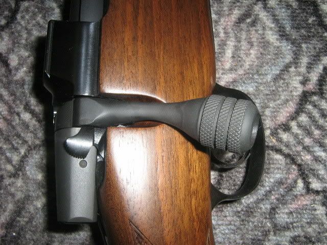

Me and my 550 Magnum in .375 H&H. Works great. Love the rifle. Put a S&B Zenith 1.5-6x42 on it. Great all around gun. The only thing I didn't like was the bolt handle..... to each his own....
Bolt before...
Bolt after....
I did it for more positive use in the winter with gloves....
