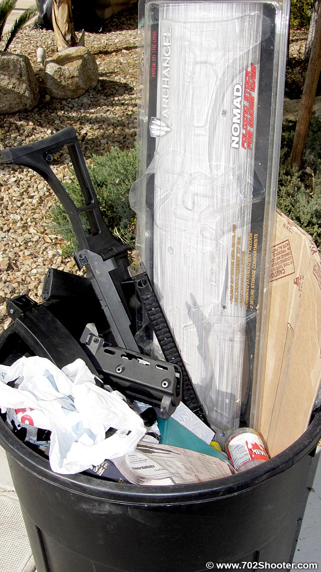

    Here's a funny review I read about the stock kit:
    When I was 16 years old, I obtained a Ruger 10/22 rifle from a co-worker. The rifle was stock so right away my dad and I hit up a gun show looking for the “cool” stuff to transform the rifle into something that a typical teenage boy would consider neat. Although not as many options as you can find these days, there was still a lot to choose from. I put on a folding stock, flash hider, extended mag release, and a cheap optic. That configuration has worked perfectly fine for me so I’ve never bothered to change it up. That being said, when I saw a local gun store advertising that they had Archangel 10/22 stocks available, I decided to check them out.
    From their website, they looked decent. Especially for the same demographic I was when I got my 10/22. Their prices are a little higher than a number of the other 10/22 stock options so I figured they should be good quality. Since most of the articles I post here are aimed for the “big kids”, I thought it would be nice to change my rifle and post about some mods that may be useful upgrades for your kid’s Ruger 10/22 rifles. I decided on the Archangel Nomad Stock also known as the Marauder. The Archangel Nomad Stock is designed to look like the HK G36 which has been used in a number of video games so it appeals to a lot of younger people.
    They say a picture is worth a thousand words.
    Even though that pic pretty much sums it up, I think a little more explanation is due.
    First off, the instructions that came with the stock were a complete joke. As a 16 year old teenager, I had zero problems tearing apart my 10/22 and making the upgrades. On the other hand, I had to go to YouTube to figure out how this POS is supposed to be installed. The video I watched was pretty short and showed things well. However, my experience with the install didn’t go quite as easily. For some reason, the company didn’t include room for your stock sights so they needed to be removed with a brass punch or some other method which hopefully will not screw up the sights or barrel should you wish to revert back to the original configuration. Even after the sights were removed, the action still did not fit into the stock. After 30 minutes with a Dremel tool and a little encouragement from a rubber mallet, the pieces all finally came together.
    The 25 round magazine that comes with this perfectly good waste of money doesn’t work so well itself. To get it to actually stay in the magwell took almost as much effort as putting the package together. Once at the range, it jammed on me every 1 to 2 rounds. About 2/3 of the way through the mag, it fell out of the gun. I literally tossed the rifle to the side and moved on to checking out the Slide Fire Solutions AK-47 stock and a couple other items I will be posting reviews on shortly.
    Obviously at this point I was unhappy with the Archangel Nomad and had zero intentions of keeping it. That brings us to the disassemble stage. Tools required? Brass punch, hex wrench, screw driver, crowbar, jaws of life, and a BFH. After using the brass punch to tap the fake suppressor off the barrel, I removed all the screws. At this point I was expecting the thing to pull apart but that didn’t happen. After dicking around with it for far too long, I grabbed the BFH and beat it to death. I had to break the thing into multiple pieces to get it off the gun. I then promptly placed the remains in an appropriate container (pictured above) for burial.
    3 things come to mind when I think about this product.
