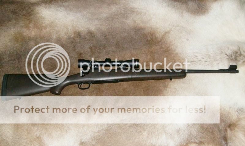

my 9.3 started life as a Husqvarna featherweight in 270 .
I found a factory barrel in 9.3x62 of the same profile and cut it down to just over 20 inches and recut a improved chamber .
the stock was broken at the wrist and poorly repaired . I carved out the insides of the wrist area and filled it with 3m's panelbond .... that ended up taking some more weight off .
with a old redfield wide field 4x scope the whole thing is under 7 pounds ( I can't remember if I had 5 rounds in the magazine or not when I weighed it ) .
I've shot 30-06's that feel like they have more recoil . I find this rifle very pleasant to shoot .

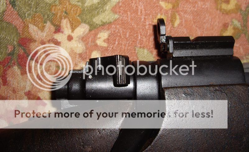

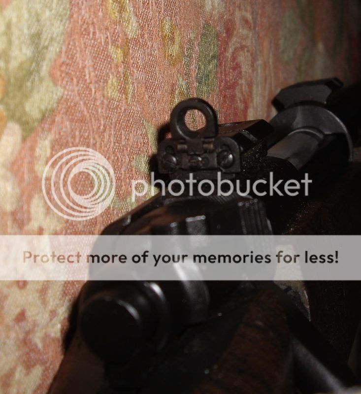

Currently have a reciever sight only on mine, it's weighing in at approx 6.7 loaded fully with 250 grain round noses going approx 2600. Could push it hotter with a different powder but why bother? It will wake you up.
