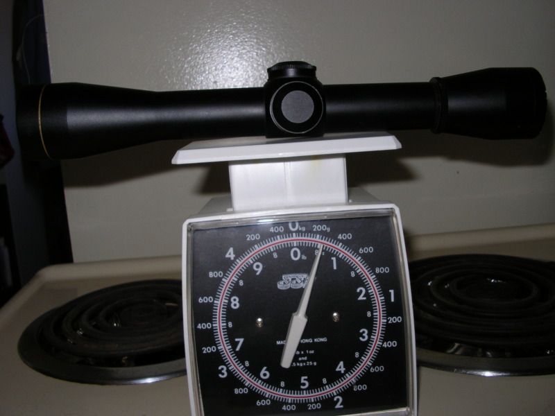

MY NEW KING weighs 8.5 with scope and MCSWIRLY stock :)
The Brno 602 is pretty damn heavy. :)
My 9.3X62 pre '64 Model 70 in Brown Precision stock weighs a tad under 8 pounds with four in the magazine.
This is a mere nine ounces of the package.
