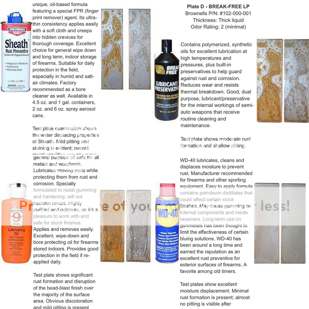

I'd be tempted to try Fluid Film.

Have you tried gun wax?
Beechwood Casey makes some gewpy stuff that may help slow the rust.

Eezox works wonders, what I use on my Merkel in the same conditions. Edited to add more info, Eezox works great but if it has a weakness its penetration is limited. WD works startlingly well despite its online reputation and is the most common rust preventative on the coast, the WD40 sucks rumours are largely ignored here it seems. Glad Brownells confirmed it. And the price and availability...
I've found G96 to be about as good as anything. That stuff will pull rust out of finishes that you'd swear didn't have even have rust. Thats sort of suggests that its penetrating where others didn't.
Smells the best too, used to use it a lot. Just haven't found it locally in awhile.
