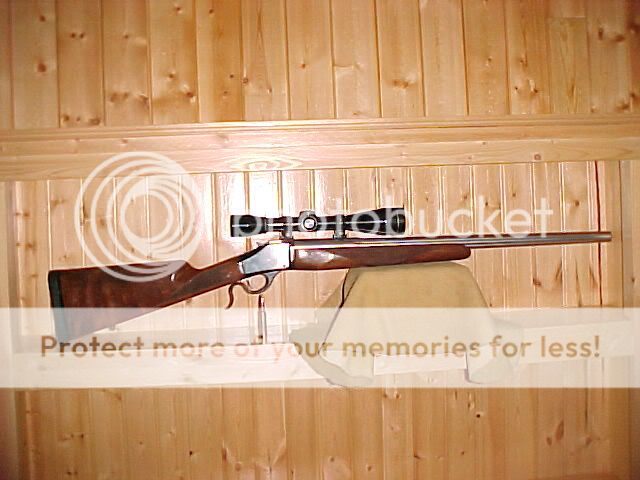

If I were building on a long action, I would prefer the 6.5-06. If on a short action, I would prefer the 260. In an unaltered Mauser 98, the 6.5x55 is my preference. These are good, practical choices. Having said this, I have built a few 6.5-284's and my own 6.5mm hunting rifle is a 256 Newton. Our choices don't always have to make sense.
