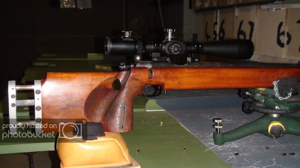

Your GX1 and boar gun appear to have the same trigger except for the lever itself. Hard to argue that this trigger has been improved upon even with the new KK500. The UIT appears to have the dual range release adjuster ahead of the housing.

It's unfortunate that there is such an absence of reliable Walther information about Walther match rimfire rifles. We do have some "official" Walther info from owners manuals, but this doesn't reveal any information about trigger model numbers. To compare, there is much more available about the various Anschutz triggers that have been available on match rimfire rifles. Sometimes different trigger models have differences that appear to be so minor that it can be difficult for people to distinguish, and this is just as true of Walther as it is of Anschutz triggers. For example, at first glance there can be little to distinguish between Anschutz 5071, 5075, 5018, and 5020 triggers that have been available since the 1980s. The 14xx triggers are also similar enough that it can be hard to tell them apart. I am no expert with regard to either make of rifle and there may well be inaccuracies here.

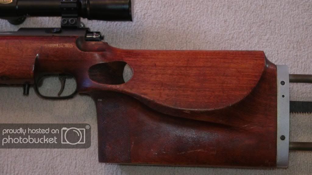

I thought so at first.... but Look closer. Hint count the screw heads![]()
Maybe I'm blind but I see 3 adjusters and a clamp screw on the trigger lever(shoe) on each…..out of view in the 1st pic.

Referring to the Walther diagram shown earlier, the 3 adjusters are #14 Trigger Weight Adjustment Screw, #15 Trigger Slack Adjustment Screw, and #16 Let-off Point Adjustment Screw. The GX1, Running Boar, and KKM triggers have a third adjusting screw, while the UIT Spezial and KK Silhouette have two.

Perhaps Walther during this era was in the practice of using whatever was available for their various models. My KK Silh. models , boar guns and GX1 all have the same model trigger with 3 adjusters and a 4th clamp screw on the trigger shoe/blade as in the photos above. My UIT Spezial also has the same trigger.
