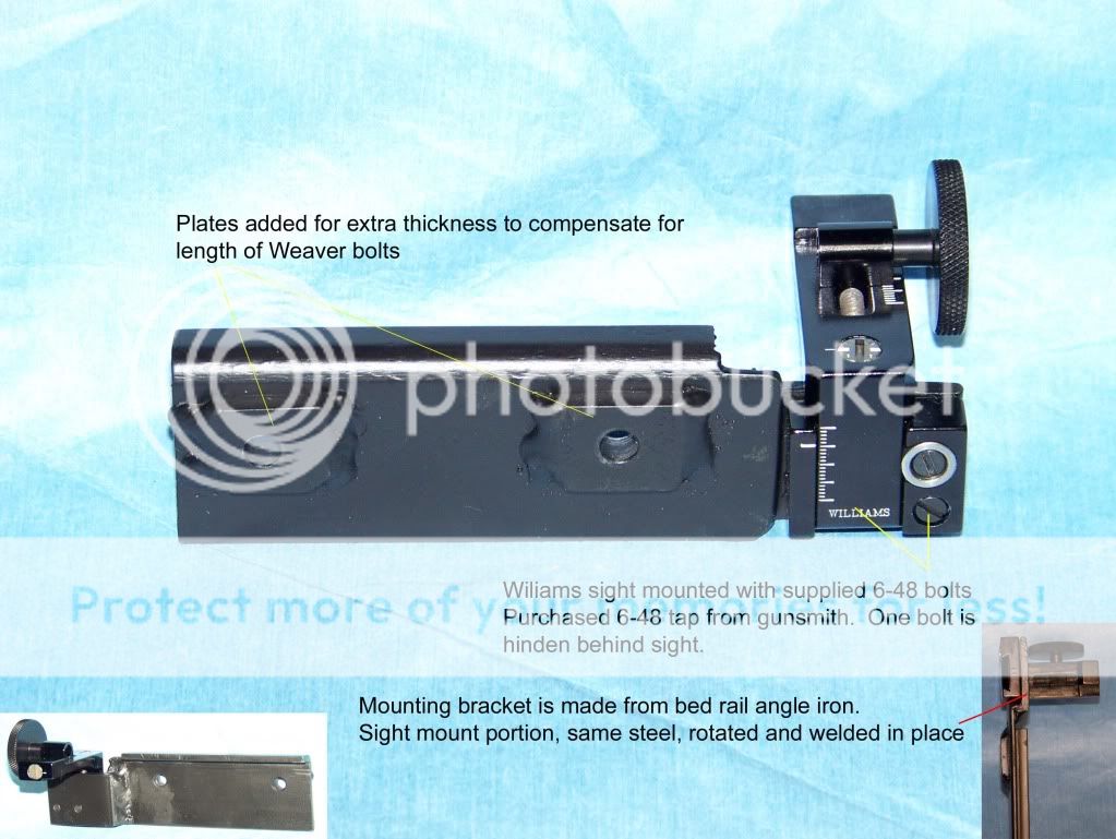

Here is one way of adding a high quality aperture sight that will not effect your regular cleaning and maintenance. (Like a Tech-Sight would) This will probable require some machine work but it could be done with hand tools by a skilled craftsman. The dust cover is drilled and taped in the same way as above. A piece of aluminium shaft with the correct diameter for the radius on your sight is all you need to get started. The rest is self evident from the photos. Just make sure that the mount is low enough. Just about any Redfield or Williams sight could be used. This one I got many years ago on Ebay.
