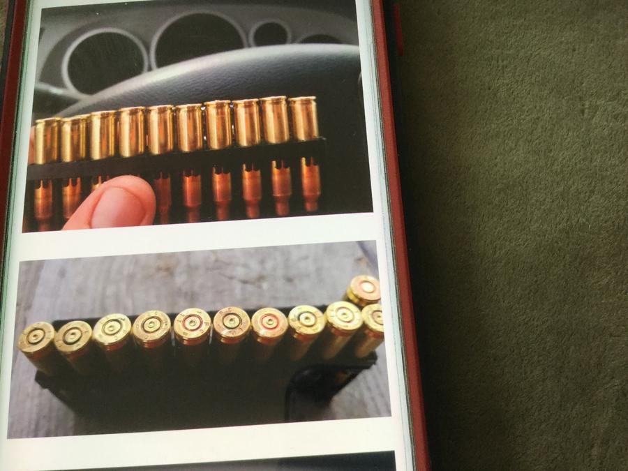

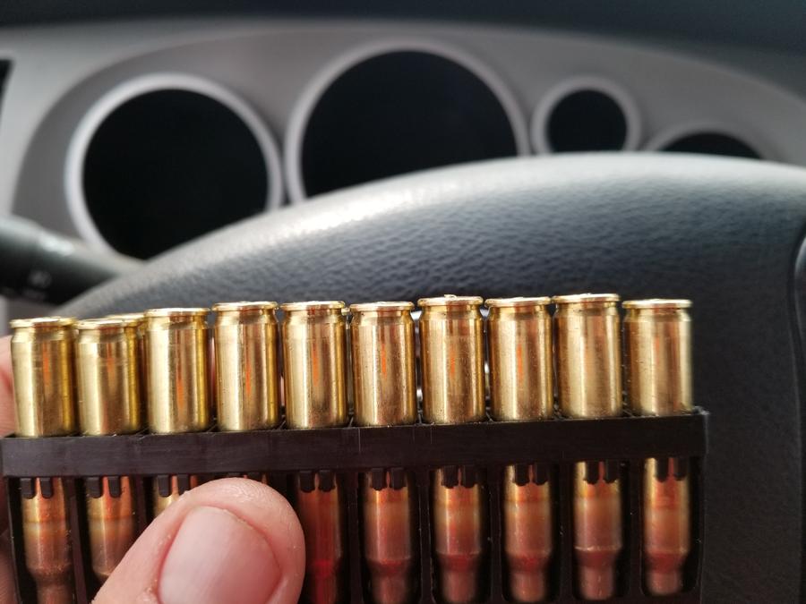

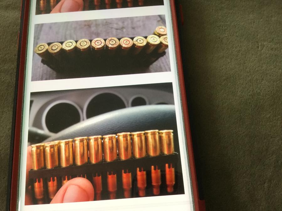

    I just got back from my second range trip with the WK180C, first trip I used Colt steel cased ammo, functioned flawlessly, not accurate enough for my liking, but it works.
    Today I fired 20 rounds of the Colt, and about 15 of this Federal, AR5.56 it is crazy hot, usually I check my brass after firing, but figured the lawyers had it covered, after firing 8 from the mag the second last jammed, the bullet, and case separated. So I had to drop the cleaning rod down the barrel to remove the bullet.
    So my day ended early, if someone knows how to host pics now let me know. 90% of the primers were cratered, gas bypassed the primer and pocket, and HEAVY extractor Mark's.

    If someone can host a pic, I'll gladly share, one primer is protruding roughly a 1/64".

    Email the pics and I’ll post them t.hanks Dale pypersplace@hotmail.com

    The brass is extremely weak. I've never found the ammo loaded hot, what do your primers and casehead look like? Like mentioned above I won't reload that crap. Had quite a few cases split in the middle of the body on the 2nd firing, split necks etc. Never finished that batch or even considered loading a 3rd time.
