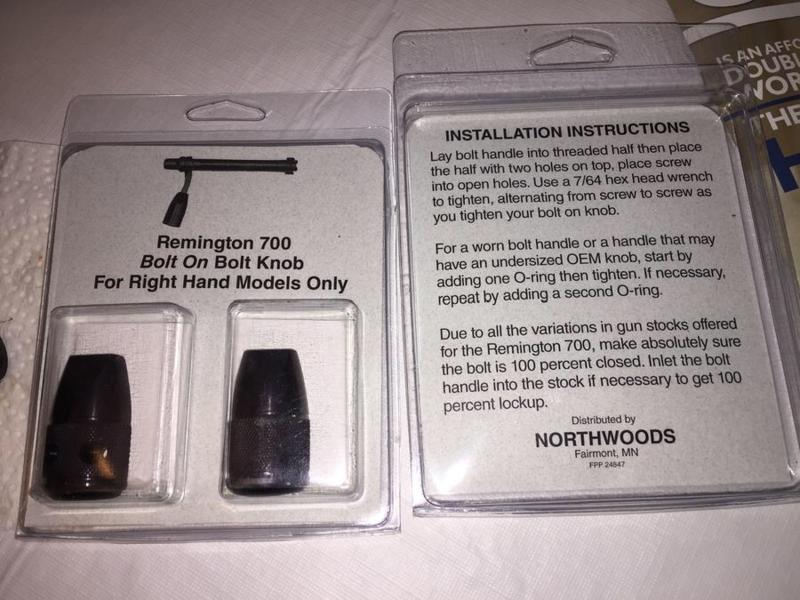

    Then I brought them home and began the install. As you can see the factory bolts are removed and rifle proved SAFE. Then I show both front and rear of clamshell packaging. Everything you need to make the install happen is included. Oh , yeah they are aluminum so on can really work this knob extension with enthusiasm.

    Here’s a closer picture of the product. See the two halves of the extension? One of them has the countersinking arrangement for the 2 x 7/64” drive screws. The instructions are very straightforward and they did suggest to “dry” fit everything and looser fits can /will / may employ the one of two O rings.
    Attachment 248327
    Heres what you get with the package:
    Attachment 248328
    They even include the Allen wrench in 7/64” size. How thoughtful is that?
    Trial fitting of the bolt knob halves and screwing down one side at a time. Both halves will wiggle for a while until tension increases. Your bolt knob fit will vary depending upon the previous age or wear. Like I mentioned somewhere on here, three bolt handles were upgraded and only the ONE needed to employ the O rings. I was really pleased with the fit of the two knobs that didn’t need an O ring.
