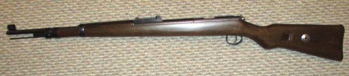

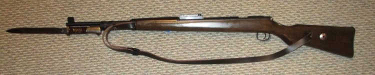

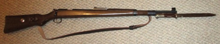

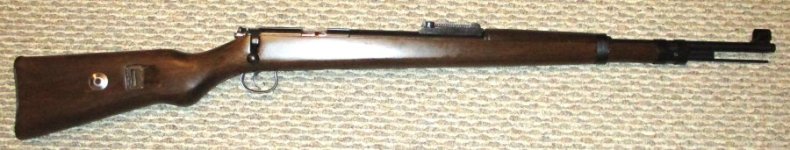

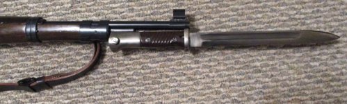

Just for a fun of it, I added a replica K98k sling and bayonet to my JW-25a. The sling is from Amazon.ca and the replica bayonet is from Militarytour.com in Winnipeg. It is a very nicely made replica of the original K98k bayonet. Pretty good quality. It fits like a glove on the rifle (see pick).
