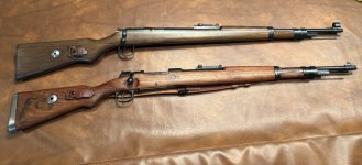

Mine was delivered today and from first looks I’m pretty happy. The bolt is VERY tight to close and definitely will need some break in.
This isn’t a “mini”, it’s the same size as a K98! Will have it to the range tomorrow.

Congratulations! You will not regret buying it. It's not a "Mini" at all unless that word refers to the rimfire caliber. Mine shoots about 2" high at 25y with iron sights with CCI Standard. I didn't want to do any irreversible modifications of the original iron sights so, I mounted a small red dot. Now it shoots like a laser.
I see that you also have a "real deal". Nice comparison. Is your real Mauser a "Russian capture"?

It’s a Russian capture, but a nice shooter!
