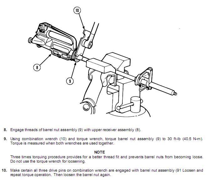

How did you take apart the upper? Or conversely, how did you assemble the upper in the first place?
Specifically, how did you hold the upper when you removed/installed the barrel nut?
The damage looks similar to what you'd see if you clamped the upper in a vice (as opposed to holding the barrel in a vice, or using a BEV block or a Reaction Rod) to undo/tighten the barrel nut.

Only thing you can do now is gently push/coerce it back into shape.
I would advise buying a better method of installing barrel nuts. Those clamshell types arent the greatest.....
I would also advise using vice jaws for clamping on the barrel. The barrel is stronger than the upper.
As per the Technical Manual
Or you could buy a Bev Block or reaction rod. Personally though, I'm not 100% in love with the idea of them for loosening barrel nuts. While hypothetically the barrel extension should not be able to unthread (tightened to 150 ft/lbs) ive seen a few barrels where they werent on that tight.....
