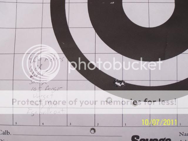

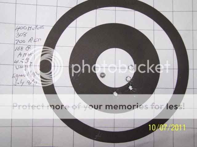

This group was fired at Eganville today, witnesses by K1ngC from cgn.This is at 400 Meters.
I actually had 2 similar 10 shot groups on sunday witnessed by Petrak but forgot the targets at the range.
The hole with the X in marker around it is actually 2 rounds.
The target was just a black x made of electrical tape which I removed.
The groups were fired from prone off of the concrete pad with a rear bag.
The gun is a savage F/tr 308. The only thing done was a bedding job by MysticPlayer ( thank you Jerry)
This gun is definitely a consistant sub - MOA gun.
