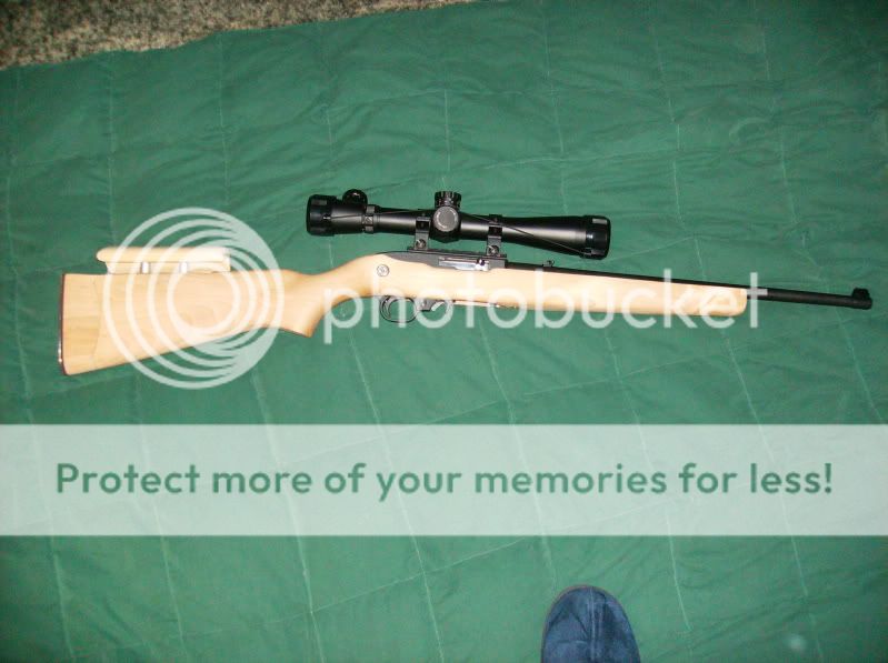

Yes, rework can yield some very accurate shooters. Reworking a barrel is only part of a package that needs to be done on a 10/22 barrel. You need decent bedding, a good trigger, and a considerably tighter chamber. I recently took a completely stock 10/22 and kept it stock except for a rear anchor pin in the action. It is by far the most accurate stock barrel I have ever seen. I cannot say that is just the chamber, the crown or the bedding, or a combination of all 3, but this rifle is amazing. These were shot at 50 yds.

Looks like a nice rework of the stock or is that something you bought.
12" would be to short all though make it pretty handy for swing around fast when the gophers are moving. I am tempted to buy a bull barrel and turn it down but I am wondering if it would need to be stress relieved after machining.
