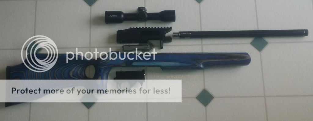

Had a few things out today to check what the barrel looked like with the stock so I thought I would take a pic.
Getting close and only a few more smallish things to get.
