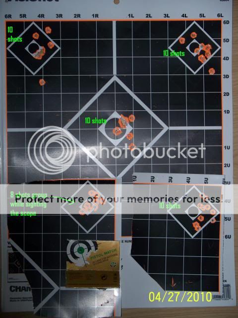

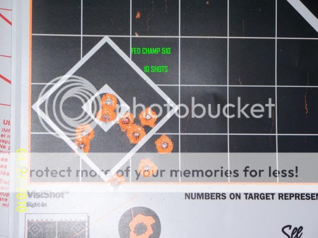

ok heres the groups...first picture is from SK ammo at 100 yards, and I can say that I'm impress, because at 25 or 50 yards there is no big differences between Match-grade and Cheap ammo, but 100y the results are here. The 2nd picture is a group from Federal Champ 510 I've done after running out of SK.
There is a noticeable improvement, but still a few flyers. If it was throwing them all over, I'd say it was the barrel. But its all vertical, so its the ammo. The barrel looks like it would hold a little over an inch (at worst) if you got the SDs down. Very decent for the price. I did find SK Match (both Pistol and Rifle) had higher SDs than Standard Plus and Pistol Match Special. I didn't try sorting them by weight or rim thickness though.

The groups seemed to be showing less vertical as you progressed. Match ammo has a lubrication on it. SDs will drop after a box or few and groups will tighten up. Avoid cleaning as often or shooting non-lubed ammo once its seasoned. Similar to moly or hBN in a centerfire...
In my experience, bi-pod's on a hard surface (bench) are the devil for vertical stringing (and accuracy in general). Go get a front sandbag, and see if it don't smarten up a whole lot. The bi-pod works much better when shooting prone with grass or some-such under the feet; but all of my guns I ever tried on a pod shot significantly better off of sandbags than they did on the pod.
