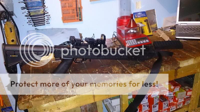

My bad-ass Dlask DAR10/22:

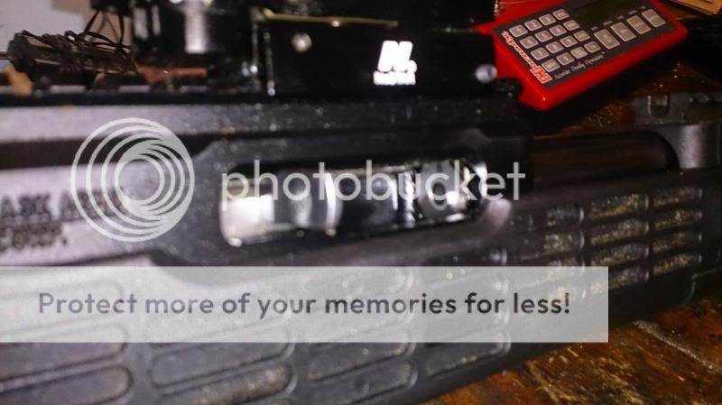

A view inside the receiver looking at barrel...
Looking down the barrel at V-block, gun upside down so the trigger group is on top.

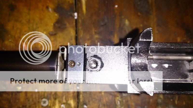

Looking directly down on adjustable V-block, note set screw in the middle of v-block. This allen head screw holds the block tight against the barrel.
Looking at V-block from the side. Note the gap between block and receiver. The set screw holds this in place so the barrel is not all the way in.
