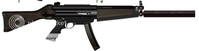

First, my concept drawing. This was done over a photo of ruger and takes into account trigger position etc...
Next image is a photo of the bare aluminum chassis with it photoshopped black and accessories added with photoshop. I guess it is a look into the future of how I hope it turns out.

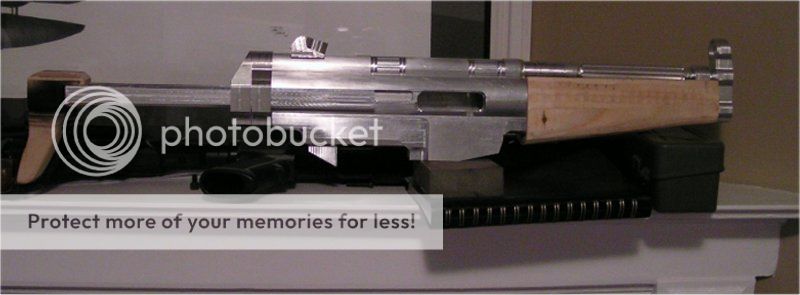

After many hours of milling, here is the chassis without the ruger inside. A few small parts, some finishing then anodizing and it will be complete. Hoping for mid-sept completion.
This has been a fun project and it is starting to take shape. It will never be a perfect replica because of the difference in shape of the two guns. Knowing how much work was involved, not sure I would have started but I'm starting to see light at the end of the tunnel. If you can make an mp5 out of ruger, i say go for it.
