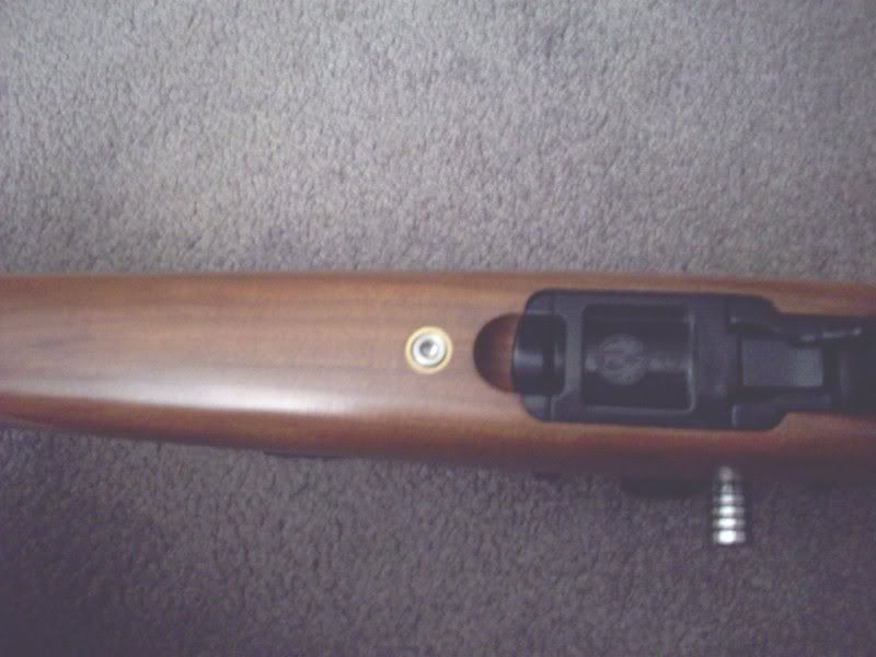

If this is what the area looks like, you can always counter-bore the hole deeper and bob would be your uncle again.

OK. Hex head screws are indeed shorter, my bedding has lifted the action a hair, and counterboring the escut...excuti... the brass thingy along with the dab o dry loc-tite will be the mod of the week for my rifle. Thank you all for your very helpful suggestions, most appreciated. I'll post back on Sunday after sending a round or two down range (oh darn more shooting:)).
