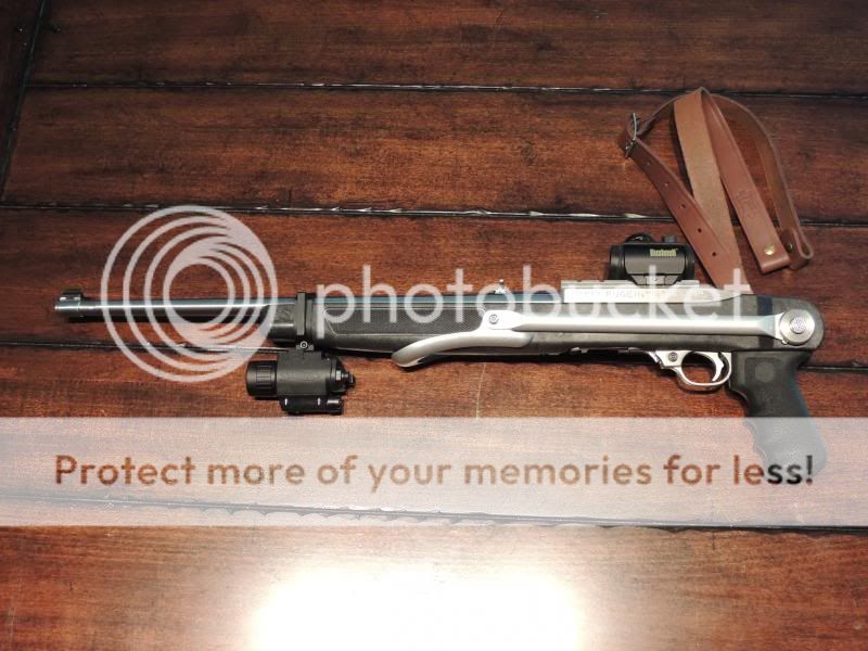

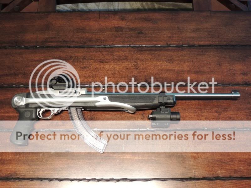

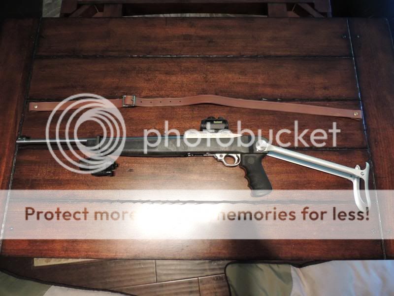

I ordered an underfolder stock from Hical and a barrel band with a sling and picatinny rails. Love the fast delivery times!
My circa 2004 10/22 dropped into the stock with no mods or inletting required.
The fit seems good, the stock locks up nice and tight.
With the TRS-25 RD, I don't get a cheek weld, more of a chin weld. I am thinking about mounting the RD on an angle mount on the right rail and removing the Ruger base so that the irons can be used as well.
The carbine is a plinking/truck gun and maybe the occasional grouse if I see one by the side of the road (hunting wise I'd use my CZ 455).
The cheap ass Walther light/laser seems to be mounted solidly on the bottom rail. Time will tell.
I am planning on drilling a sling stud into the back end of the stock and will go with a 2 point sling.
It feels very handy and solid, the stock folds with a BC steel lip 25 round mag inserted but I like the way it handles with the 10 round Ruger magazine better.
OAL folded is 26.5". Whew!
