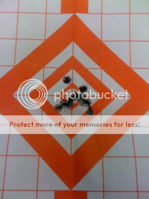

I have never subscribed to the idea that a 10 shot group was neccissarily a snap shot of a rifles true accuracy.
On the other hand I had a real good day at the range yesterday, I had 10 shells left and I decided to try a 10 shot group to see if the bedding & trigger job I had just done on a brand new rifle was 'good'.
Needless to say I think this one is pretty good, Factory rifle, Factory barrel, Factory ammo....... What say you?
The result;
The one high and to the righ was all me..... I twitched when my 'rear bag moved slightly...... Thats what happens when you use 3 boxes of shells to as a rear bag!
I am not a believer in 3 shot groups and wish people would not post them. I prefer 8 or even 10 shots because in my case shots 3 to 10 often help fill the big gap between shots 1 and 2.
Pitty I have little ability to read my groups and tell what I'm doing wrong.
Very good group imo with factory ammo.
Looks pretty good to me. I'd say you can pretty fairly call that an honest 1-MOA rifle, especially if you are able to do that most of the time you try to. Which might not sound so impressive when compared to easily- and lightly- made internet claims, but it actually a pretty decent level of performance to actually achieve.
Nice shooting ! I normally shoot, and post/quote, in 5 shot groups as, like a previous poster, I think 3 shot groups are not enough to make accuracy claims. I read a while back that 7 shot groups are thought to be the most statistically viable but I can't recall the math details behind that claim. Either which way your 10 shot group is very nice - good for you !
The rifle is a Remington SPS Tacical, I bedded the entire barrel channel and weighed it down with 8500 grains of cast boolits (3500 in the forestock and 5000 in the butt). I used a brownelles Acra glass (GEL) bedding kit. I wasnt planning on putting a trigger on it as it already had a x-mark pro trigger on it, but I managed to snap the trigger off at the point where the adjustment screw penetrates the trigger paddle...... So I bought a timney from a local shop and presto.
The scope..... well I was in a rush to try it out, all I had sitting around was a cheapo Tasco 2.5 to 10 rimfire scope....... Needless to say better glass is in the plans.
I was shooting off a Harris bi-pod (one with out the swivel), and I had forgotten my rear bag, so I was using a couple of boxes of shells to support the butt of the rifle.
I had 5 differnt types of ammo to see which one my rifle liked best, all of them shot at least MOA at 100y (3 & 5 shot groups).
Winds were from my 10 o`clock to my 4 o`clock @ 30Kph and the temp was 31c
The ammo is Hornady Match ammo, 168gr A-Max...... After shooting this group my first stop on the way back into town was to the shop where I bought the ammo to buy up the rest of their stock of the ammo...... I could't resist.
Next step is to build a load, and then see what the rifle can really do!
I didn't post the range in the first post (I thought I had) but that is a 200y group..... I would have been happy to see that size group in a 3 or 5 shot, but I figgure thats a real nice 200y group!

Dip that rifle in loc tite. Nice group and it will only get better when you tune a load for it. Id like to see your load development with some good glass.
Edit: Didn't read that you were using match ammo.
You might be able to make an argument that large round count groups are not needed for well tuned bolt guns as long as you are comparing such. Trouble is, how do you know a rifle is behaving right if you don't shoot large round count groups?
Smaller round groups for testing the precision of semis, particularly piston bangers, and rifles that are not well tuned in general does not work well. It is really easy to get the odd 3 rnd group that is nice, and assume that the other bad groups are a shooter problem, or a load problem, when in reality, it is a rifle problem.
I have seen many m14s, XCRs, and similar rifles shoot the odd nice 3 shot, then the other 2 out of the mag go haywire. Or 5 shots group well, but aren't near the established point of aim. This usually sorts itself out with a couple of honest 10 shot groups though.

BTW, what you have above is great. Nice to see that it is centered on the target as well. Should have put the one on the top right a little higher for the frowny face ;)

Were you at the range yesterday (or any other day) with me....... Cause that sounds like something I may have or may not have done :D
I understand the reasoning behind the '10 shot group', but I just don't really belive it has any bearing when doing a new 'ammo' or new 'load' test..... I do shoot the odd 10 shot group..... You will notice this is the first one I have ever posted :rolleyes: I have never had a 'good' 10 shot group up till this time (exluding pistols from a ransom rest), for this reason I never post them :cool:
