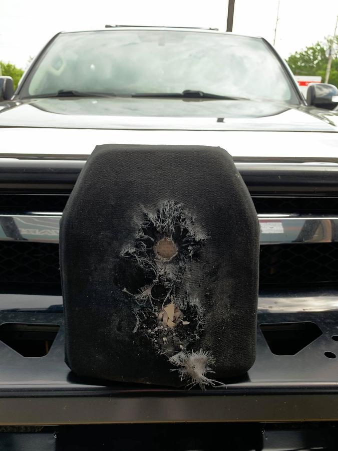

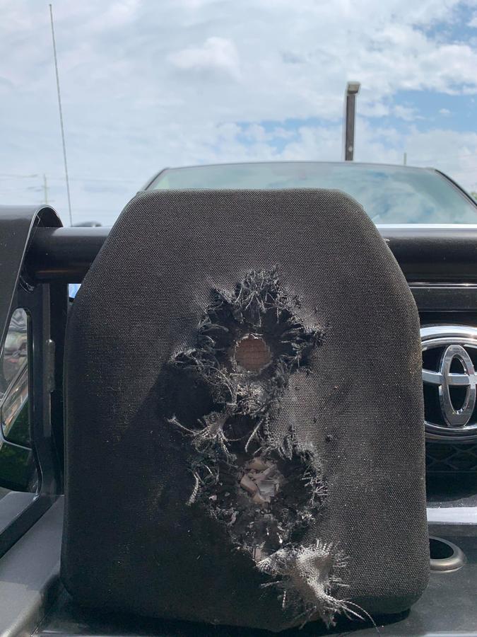

10x12 muti curved shooters cut LIV NIJ certfied NIJ 06 RCMP contract

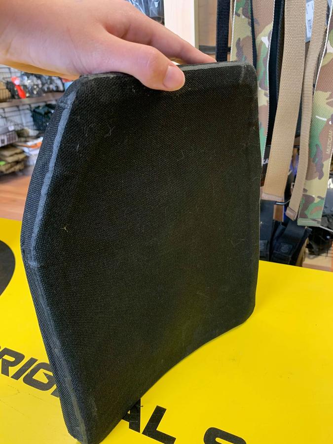

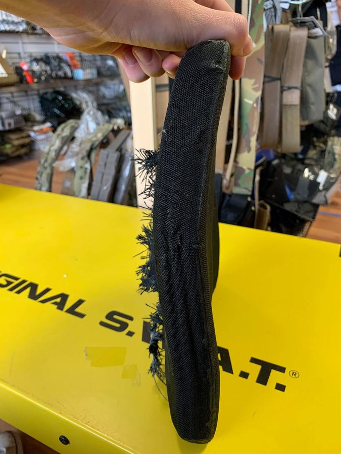

Any photo's of the back of the plates?
Are you simply looking to see if there was a penetration, or are you concerned with how much deformation there was? NIJ specs allow up to 25mm of deformation.
I wanted to see the condition of the back, deformation is expected, but was the backing torn apart with the round almost penetrating or just bulge

thank you for the pics. i already ordered a set but its nice to see, that is alot less backface than i have seen from some other plates ive seen on the gun youtubes. will you be stocking these full time or is this a once its gone its gone thing?
