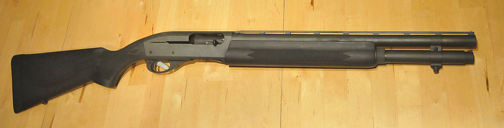

Anyway....my plan for the 11-87 was to try and get as close to my old 11-87 police as I could. I have a close shooting buddy who runs a well equipped CNC machine shop, and while paying him a visit one afternoon we chucked the 11-87 up on one of his older manual lathes and parted it off at 18.6 inches (below that gets us into legal trouble up here in Canada). He put a beautiful rounded crown on it, and we turned back the vented rib to the closes attachment point.
Then we leveled it up in the vice of one of his manual mills, dialed in the center of the rib, and proceeded to drill and tap the small hole for a new bead I had ordered from Brownells. When I got the gun home I applied a bit of cold-blue to the muzzle and rib; the result looked like it could have come from the Remington Factory!
When I got it home, I was disappointed to discover that the shell lifter was misformed, being too long to be able to properly clear the shell latch when feeding shells into the mag tube. 5 minutes on my belt sander took care of that, and she was soon manually cycling ammo no-problemo...woohoo!
I was PUMPED!
Off to the range I went, where I was somewhat downcast to discover that the gas system would not cycle properly with anything other than full power slug and buckshot. This was not un-expected though, as all my reading here served as ample warning. Rifling around my gun room, I found some replacement brownells o-rings, so I added another o-ring to the system and went back to the range. There was minor improvement, as the gun would now cycle high brass upland loads, but not the heavy field loads I was hoping for. Back to the shop I went, and we opened up the gas ports to 0.125. This, in combination with the extra o-ring, got the gun to the point that it would just cycle the 3.25 DRAM heavy field loads, but nothing lighter. By now I was pumped, as the heavy field loads are almost as cheap as the cheap skeet loads, and the gun still seemed to eat the more powerful buck and slug without banging around or beating itself up too much.
I drilled out the mag tube tabs, and installed a 2 round extension with a permanent 1 round plug
, and also replaced the plastic follower with one from Vang Comp.
She was ready to rumble:
WOOHOO!
I've had it out at my acreage the past couple weekends...and have been having a TOTAL gas with it! It's brought me back to my initial love for the shotgun, and I think I'm going take it out for this year's deer hunting season. We bought a clay thrower, and after one weekend of that my wife made me go out and get her a 20 gauge 870, as she was having a riot too!
