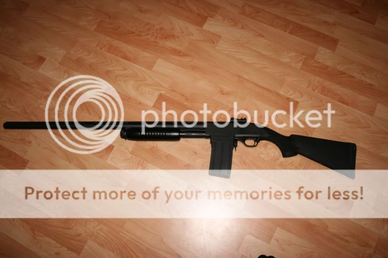

Here is my Grizz w/ my 30" rem barrel, full choke.
I had a similar question awhile ago about putting the grizz bbl on my rem receiver... Works fine for me.
