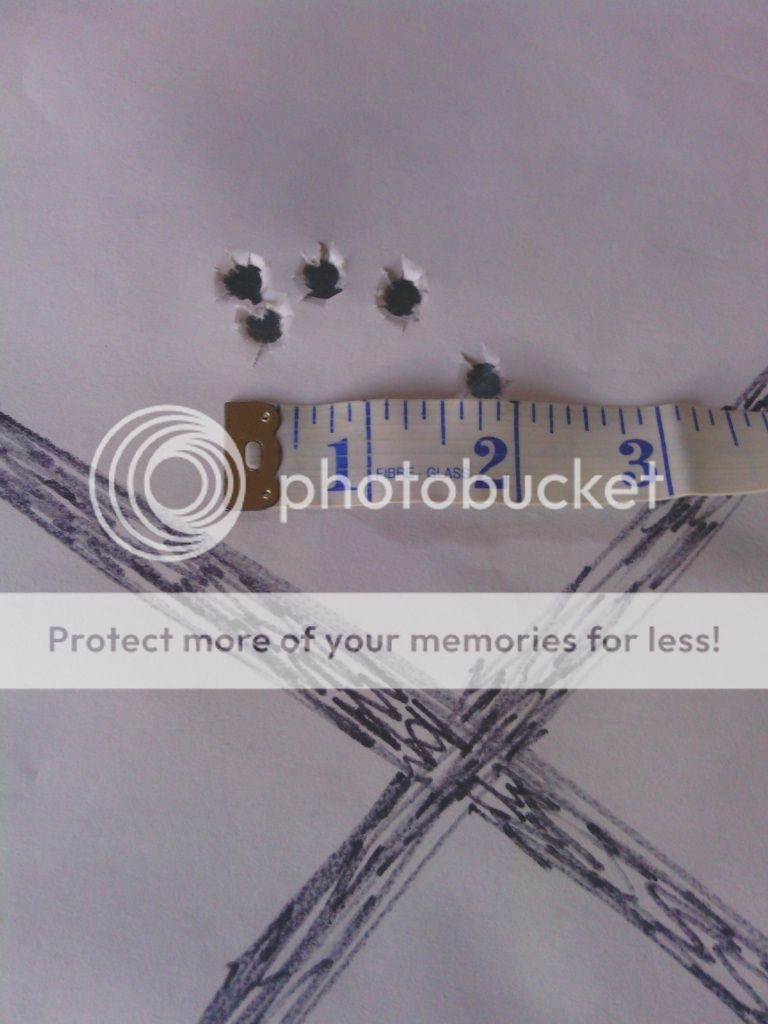

Alright
31 Degree evening around 7pm I started, finished at 7:45pm (now).
id set up in the Shade
fired the first of the 41gr loadings.
waited a good while until the tube wasn't warm.. fired.
same again for the first 4! then had trouble chambering one , so I got it in with little bita force an fired it pretty much straight away..
The Result
the first 3 were close to the inch, then with the 5 it went out a little bit but cant be sure with that last round but either way I'm settled... 41 varget
very similar POI to the 139 hornady interlocks, this sits about 3 inch high at 100m though the 139s are around 2/2.5 ... Happy to use both for Deer especially.
IMG_20170106_194004_559.jpg~original
It isn't a twist issue , 120 isn't "too light".
No way that a 7-08 could push a 120 grain projectile to the point of having problems.
That 9" twist will work with weights up to bullets in the 160gr ish range for the -08.Anything from 100gr to 160gr will typically work, it is about load tuning.
There are LOTS of loaders using 120gr projectiles in 7/08 with factory twist rates with very good results.
Looks like the OP is getting things settled in.
Your rifle has a 1-9" twist right? 120gr is light for that twist rate. I can't see getting much better than 1.5" groups out of it.
Maybe tweaking your loads might gain some improvement, but that's pretty much what I would expect.
Edit- I also noticed the bullets you are using are soft point. I think you are realistically doing pretty good.

Yeah I tend to lean toward some Fact in there that is saying this particular Rifle doesn't like 120gr Sierras too much, an there is some doubt of my shooting, it is not benchrest quality..
I don't normally 5 shot group, but did with this particular to eliminate the two in an one out, with that group there is still some user error involved but I was confident in the let off an all that.
slowing them down has definatly helped out.

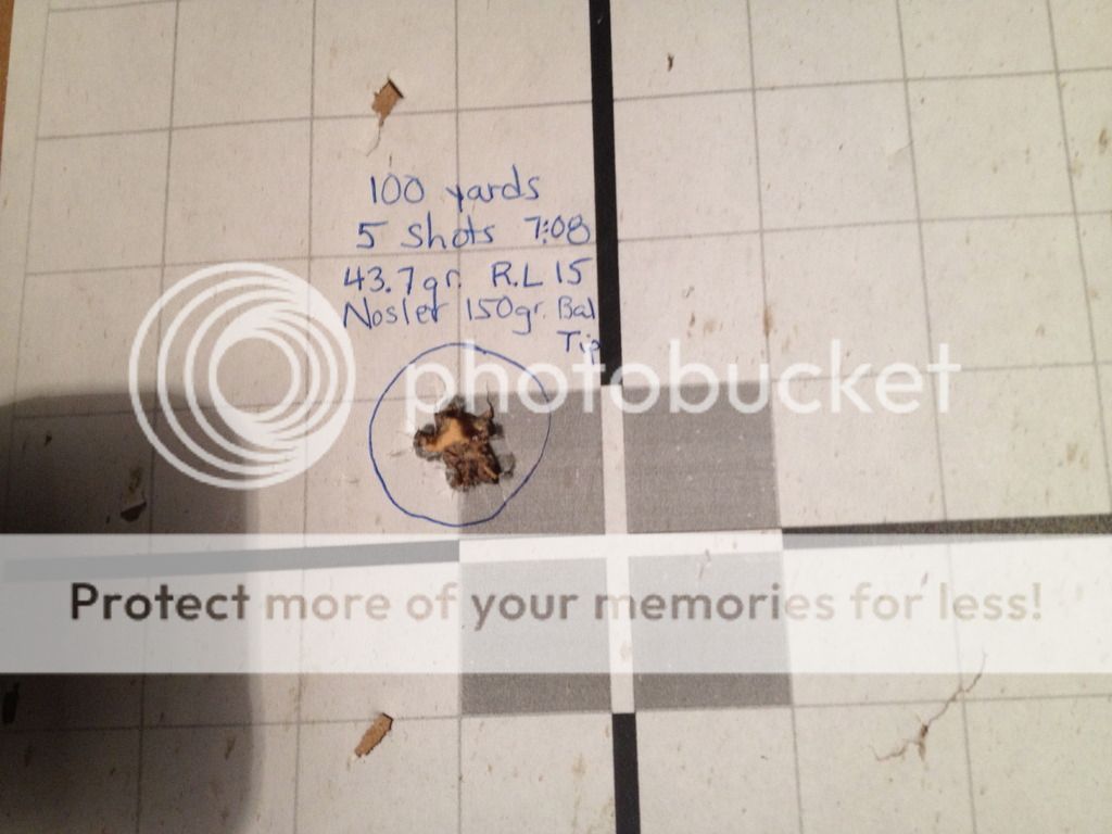

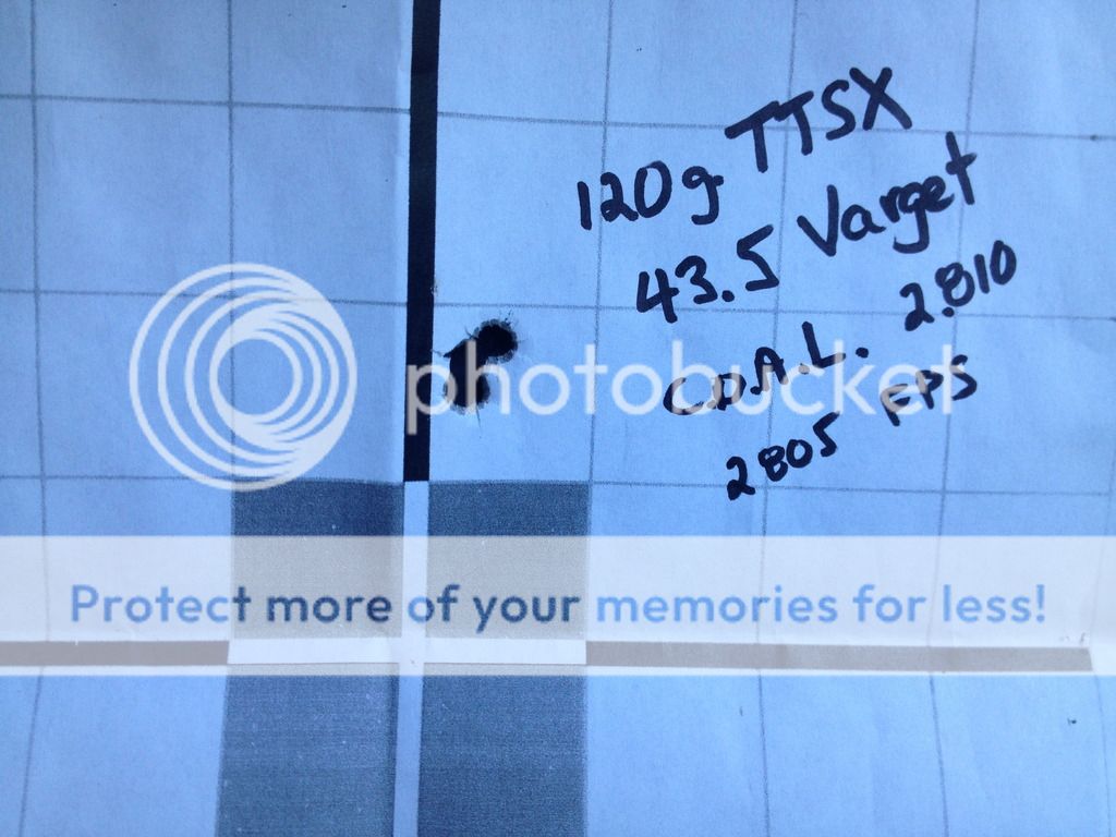

I wouldn't be too sure about that. My Sako 85 has a 1-9.5 twist and the load development I did using 120 gr. TTSX for hunting is very accurate and I'm not shooting off the most stable platform,,,usually the tailgate of my truck and I've had lots of grouping in the 1/2" MOA range.
That being said, maybe my gun shoots most bullet weights well once an OCW load workup is completed. I use 150 gr. BTs for practice shooting and they're very accurate as well.
Five shot group:

Berger does not list "optimal" twists. Those are minimum required twists.
Wasn't it your post that said a 1-9.5 twist won't shoot a 120 gr. bullet very well?? My mistake if it wasn't. In any event, my 120 gr. bullets shoot like a hot damn with that twist rate.
I said that it isn't optimal. Over stabilization of bullets will make defects in the bullet more apparent. Soft point bullets are not going to be totally uniform. Overspinning them will cause a loss of accuracy.
IE, I found that a 1-8 twist Tikka fired a 55gr American eagle bullet like crap. I was able to get good results out of a Hornady 53gr.
Higher quality (or at least more uniform) bullets will be affected less by over stabilization.
