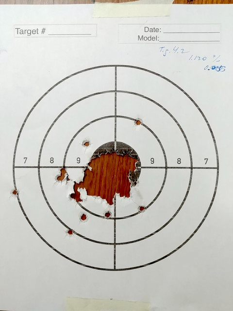

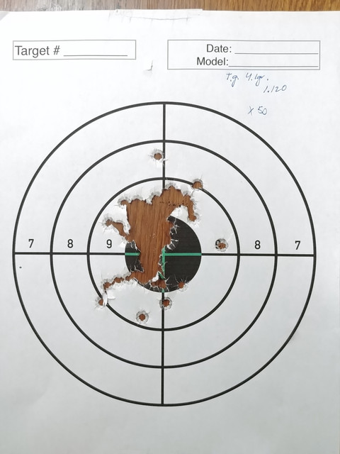

4.1gr
4.2gr
4.3gr (I pulled a couple, but seems to have less consistency).
Of course, 4.1gr shot the smoothest. I will be loading for competitions in the spring so I may stick with 4.1gr for that. For now, I'm just putting holes in paper and learning the craft.

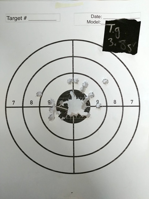

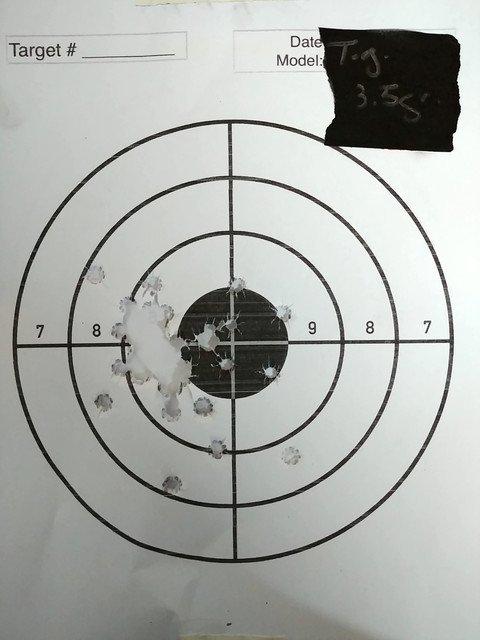

Went to the range this morning and loaded 50x @3.5gr and 50x @3.8gr (AOL 1.120").
3.5gr (no my best shooting...)
3.8gr
Everything cycled just fine. Ejection pattern on the 3.5gr was a little short, but no functional issues. I would say, I did have plenty of unburned powder or something blow back and deposit on my hands when using the 3.5gr load. Not sure what that was.
Theres a chance the lighter loads don't have enough pressure to properly seal in the chamber and avoid sending gases back through the chamber. Just a thought.
